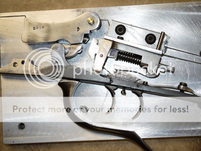

To facilitate the action modifications needed to allow firing pin retraction before the breach block begins to rotate, I made a testing fixture.
The first photo shows the action modifications. An extension has been added to the lever and the lower leg of the striker hammer has been extended.
The action is shown fully cocked.

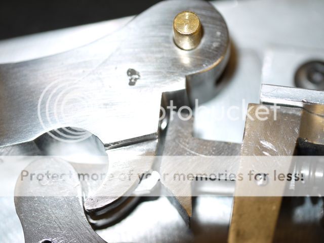

The picture below shows the initial phase of cocking. The striker is retracted before the breach block begins to rotate.
A return spring has been added to the firing pin to give prompt firing pin retraction as soon as the hammer pressure is relieved.

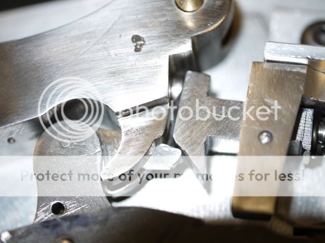

The breach block begins to rotate but is not yet in contact with the striker.

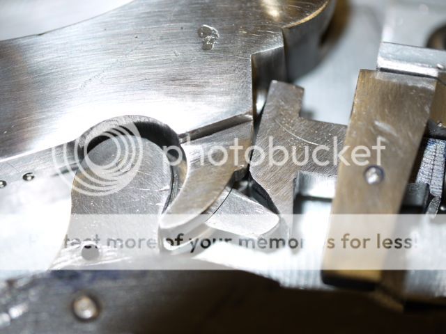

The breach block has rotated enough to contact the striker and complete the cocking.
