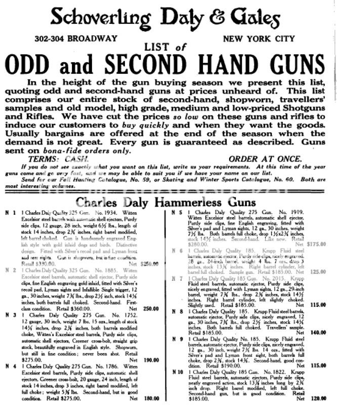

Forest & Stream 1912 2nd-Hand Daly Gun list. Lists serial numbers and description. Can't say why Purdy is spelled without an e. Curious if anyone that reads this actually owns one of the aforementioned.
http://www.doublegunshop.com/forums/ubbt...true#Post291216
Just wanted to combine some info on Daly threads.
