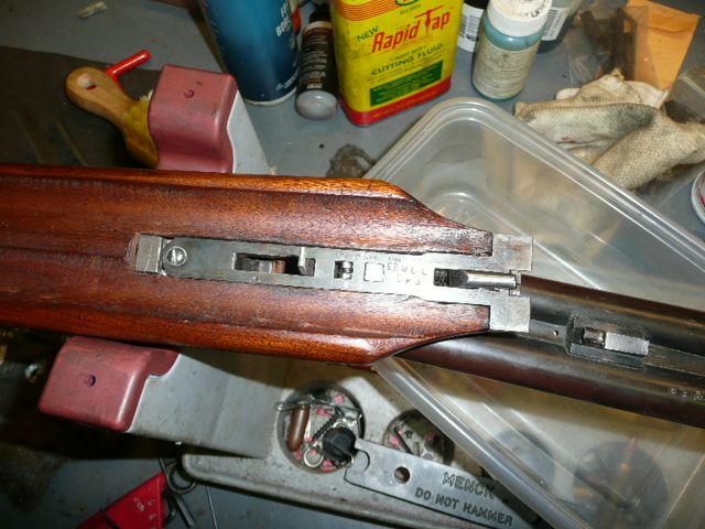

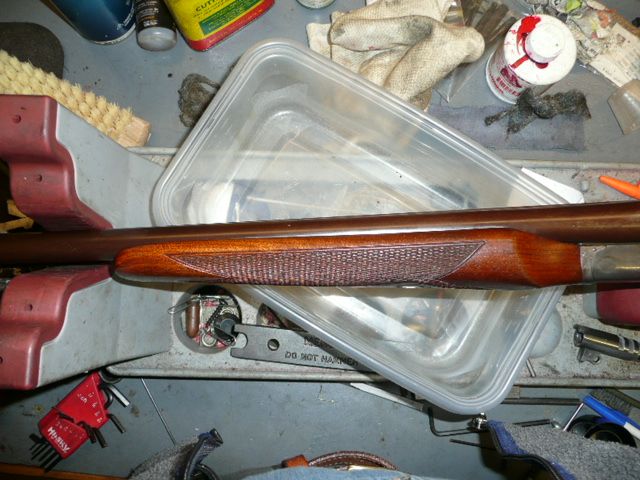

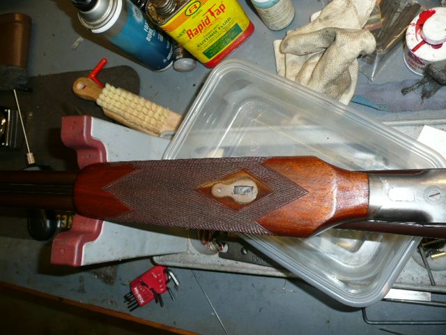

Thanks for the suggestions so far. Here are some photos of the gun in question. The stockwork may not be original -- I just don't know. The gun belongs to a customer, so he is not interested in taking it to splinter design.

It is aftermarket! There should be a bolt from the tip to the frount of the forend iron. Also on the barrels the lump that recieves the load is the type for a splinter. If you get the iron to stay in place and the gun is shot much that will be next likely failure.

I agree with Bill, aftermarket for sure. It is just too much to ask of that forend fastener to hold that big chunk of wood. If you get the forend latch to hold, the forend loop and maybe the bottom rib will be a point of failure.
It's a pretty attractive restock if you like that sort of thing but it is not going to work in the long run. I promise you that if he grasped a splinter properly it will feel secure. A lot of old waterfowl sxs's had splinter forends. You hold the barrels.
