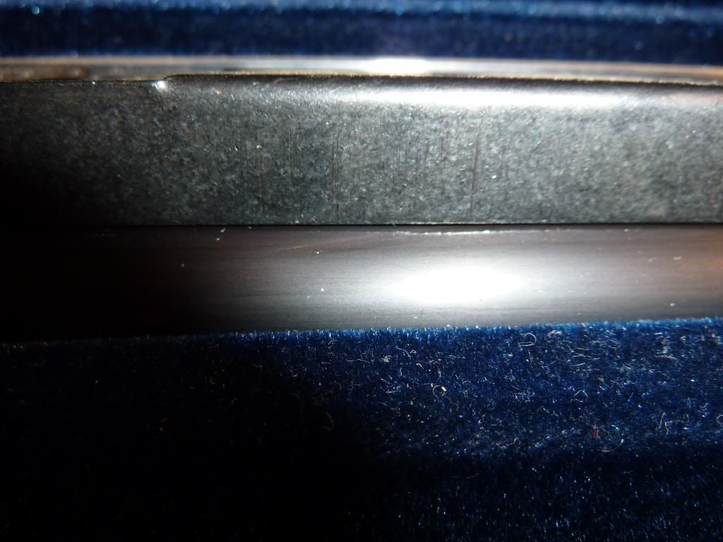

Thought I would give a quick update. I took the gun to a well respected gunmaker and his advice was to send it to Kirk Merrington. Kirk received it yesterday and has the dent out. He said it was a bad dent due to the length as it was more of a crease. (which is what I suspected) I measured the barrels at .027" at the dent which Kirk confirmed. I am now having the barrels restruck and the engraving picked up so they should look like new when all is said and done. I am sacrificing .002-.003" to have all traces of the dent removed. I will have enough wall thickness left though I liked .027" better! I will post pics of the finished barrels when I receive them.

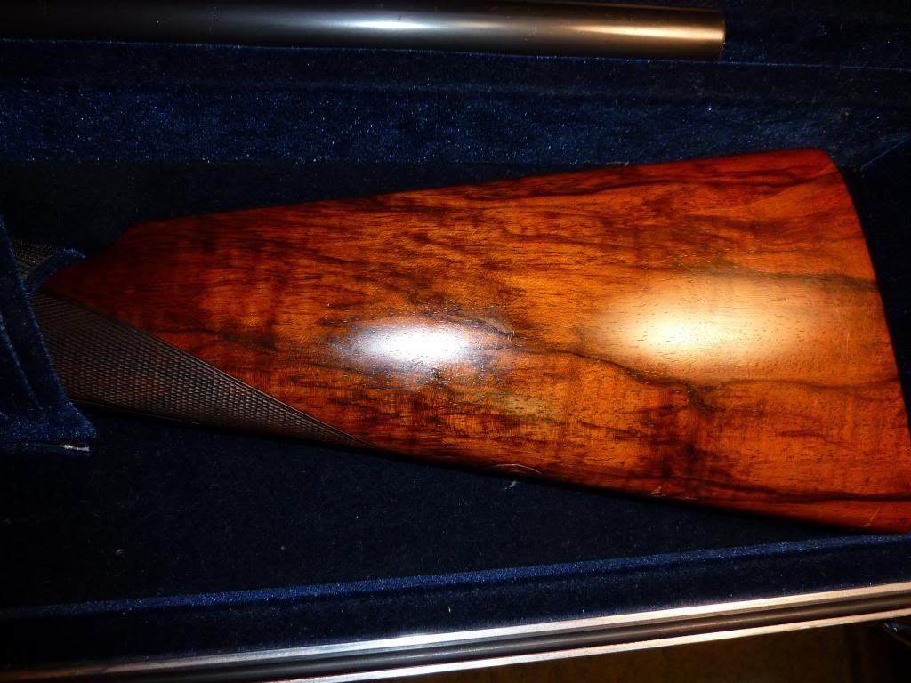

The barrels came back today from Mr. Merrington. They measure at .025" where the dent was just as he said. The engraving looks great though I do not know who he sent them to for that part of it and the reblacking looks perfect to me. I am ecstatic with the job and very pleased to get them back so soon. I will add some pics of the barrels later but here are a few of the action and wood.
