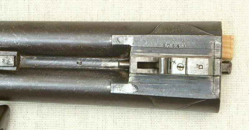

Short barrels have a D on the barrel lump and a R on the barrel flat. The long barrels have a R on the forend hanger. The recevier has a D next to the sn.

I would like to see photos but I think the D means damascus. (T was used for twist.) The R means it went back to the factory for some sort of repair or, perhaps in this case, a new set of barrels. It is too bad that that era records are missing. The story I got was they were destroyed in an office fire.
Here is a Grade 3. Does your D look similar?

Exactly the same except mine is a grade 2. Thanks for the info. I'm guessing this gun is a 1889-1891 vintage.
