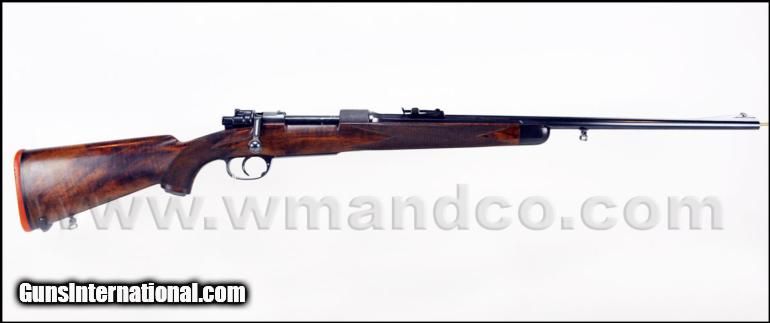

You would also want to use a stock with a higher than usual comb to accomodate the height of the scope tube. This Griffin & Howe stocked Model B might give you some ideas about stock design:

The Photo you have posted is exactly the sort of inspiration I can learn from and take forward.

And a more open pistol grip than the example pictured. I would go with the general layout of a European "stalking rifle" with a bolt action. Slim, trim, with an unfashionably long light barrel. Unlikely to be a bench rest accurate rifle, but a game killer that is easy on the arm and easy on the eyes.
