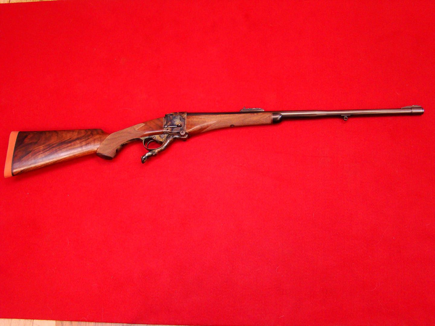

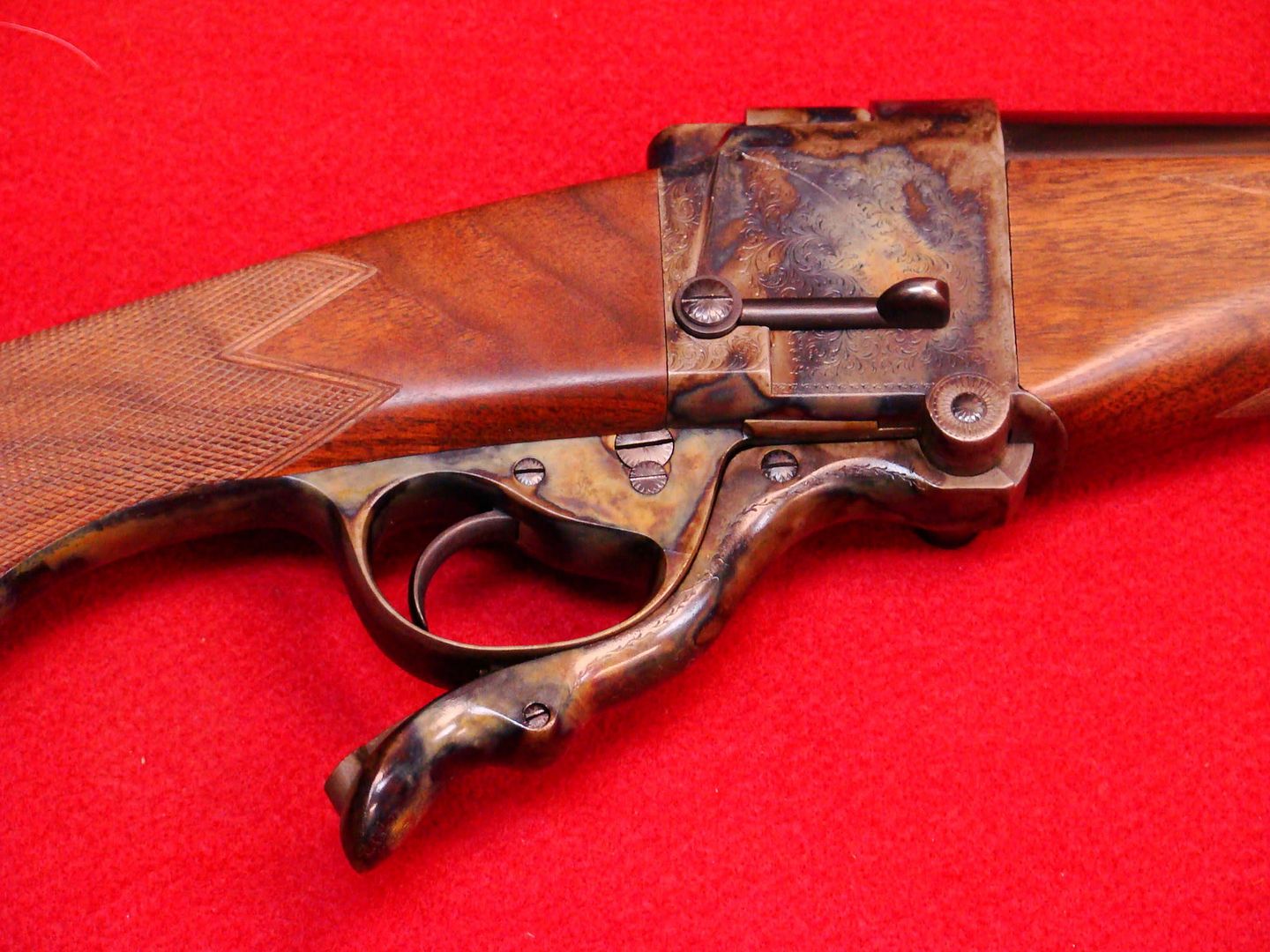

often times, less is more when it comes to restoration. I try to leave as much history and soul in the gun as is possible. The current condition often dictates what should be be done to the firearm. That and budget play the biggest role for most of my clients when determining what will be involved in the job. Here are 2 recently completed guns. The Henry retains much of its original patina on the case hardened parts giving it a much more "original" look and feel while the Jeffery looks darn close to new. The Jeffery required a much more extensive body of work including new wood and having the engraving re-cut. I personally prefer keeping as much original condition as is practical.
the Henry
the Jeffery
