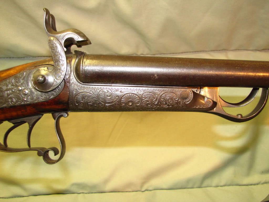

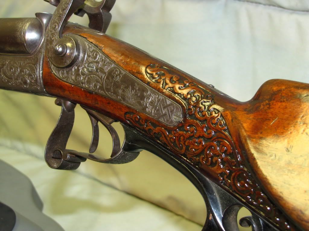

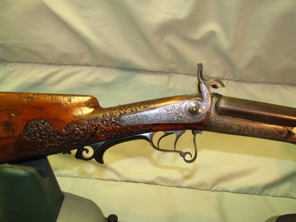

Hello gentlemen,
I need some help Identifying this unusual double. A good friend of mine wanted me to help him with an estimated value and on this particular gun I can be of little help. I have yet to encounter anything quite like it. I noticed the orientation of the hammers. They appear to strike the top of the breech a pin fire perhaps or some kind muzzleloader with a rare ignition system? He tells me its a Zolli and thats all I know. Any info would be very much appreciated and if someone can provide an estimated value that would be great
Best Regards,
Dan

are you sure its a muzzleloader? it looks like a hinge pin in the one shot and some slight gap at the breech face. and in those pictures I do not see a ramrod thimble.
a pin fire will have a small notch on the top of the back of the barrels.
any proof marks under the barrels?

Based on what I see, which isn't enough, I would guess its a pin fire. Looks German or Austrian. Would need more pics.

It's not the ignition system that is unique but the breeching mechanism. I'm going to say Bohemian origin but probably Belgian sourced from the 1870s. Yeah, let's see the marks.

From what I can see it is probably a pin fire. A good close up photo the top of the breech end of the barrels would answer the question.
A question" Does the front of the trigger guard move forward?

That was a common method of opening for a time but it seems that it is blended with the rest and considering the contraption forward of the action, I would say not.

I think you pull down the hook thingies and the bbl's will slide forward to open the breech. I could be wrong I often am

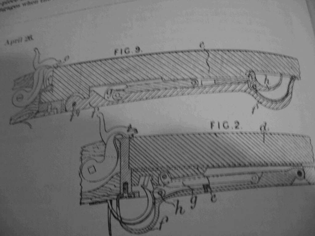

Similar, but the hook thingies are toward the breech
http://www.shotgunworld.com/bbs/viewtopic.php?f=2&t=303169
From the link Drew posted, John Lyell of Aberdeen was active in 1878. William Harvey was granted patent 1056 on April 26, 1860.
This gun appears to be a variation on the Harvey patent.
