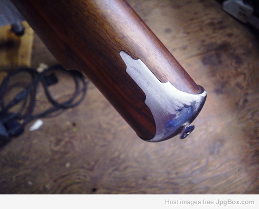

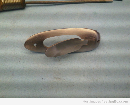

Track of the wolf is the ticket for steel buttplates that can be re-shaped. when I needed to make a trapdoor buttplate for a project that required a two diameter peak I bought one of their plates that was well oversized. cost was 20 bucks + shipping.

Thanks guys I was heading that route ,and I've been looking at the Neidner style from Sunny Hill (I believe ) at Brownell's ...the rifle is turning out much lighter than its original configuration so it will kick a little I guess but honestly recoil is not an issue for me,and with the through bolt design of the Enfield a trapdoor would allow instant access if it needed tightening or maintenance .

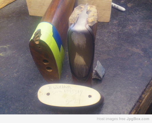

Nice work Newton 1131!
