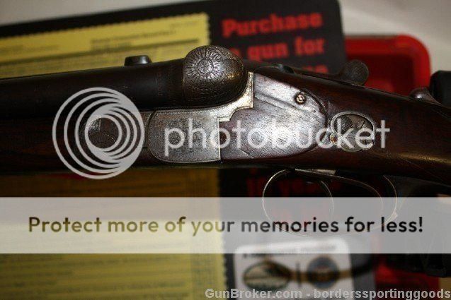

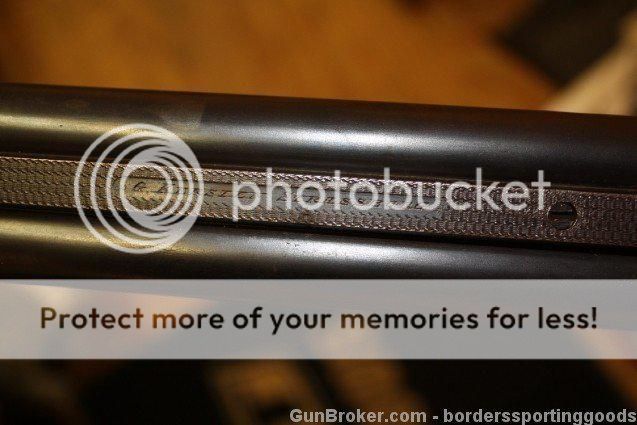

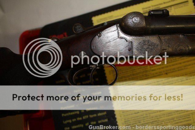

Gustav Kersten & Vierordt & Cie - Strassburg Verschluß - Marke Luchs - 1907 advert
Does it resemble the following:
It has DRGM 252511 on the toplever as well as what looks to be Modele I, so that along with the advert notes it was covered by a registered design.
I've read some bits and pieces that some design circa 1913 incorporated the Simon-Jaeger Verschluß & that of Gustav Kersten.

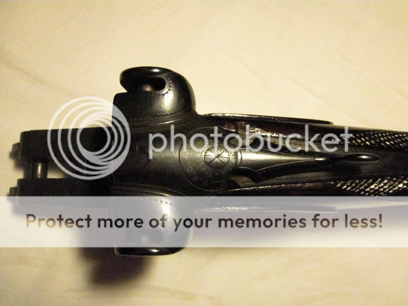

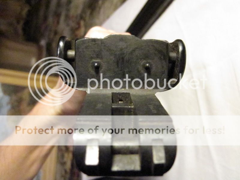

And there were a few drillings:
G. Kersten Strassburg

Raimey, your 2 posts above show a bunch of red X's rather than photos.
Posts: 3,660
Likes: 8
Posts: 3,660
Likes: 8
Raimey, thanks for posting the photos. They look odd, to say the least.
