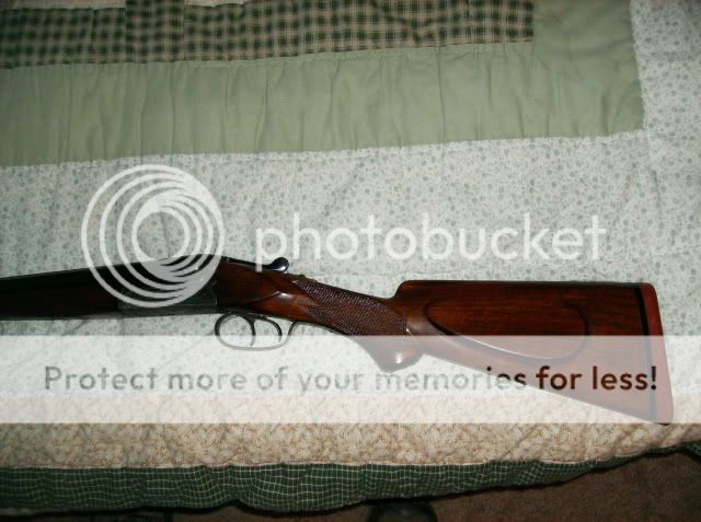

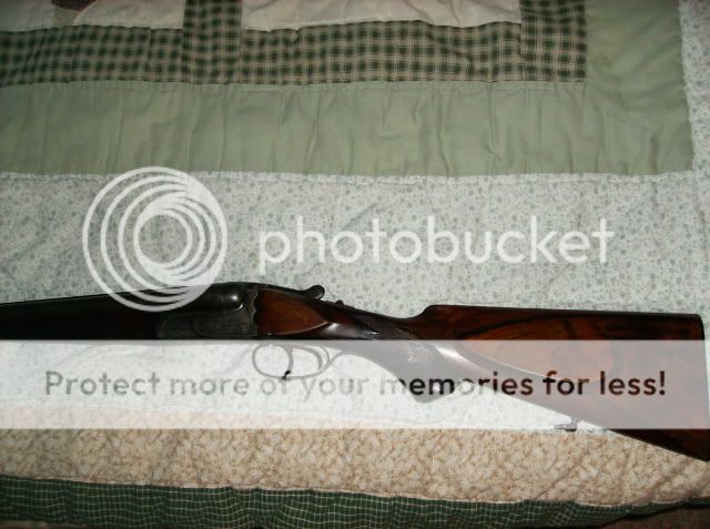

Okay here are some pictures of gun#1.
Can anyone help out with this one and give a possible value?

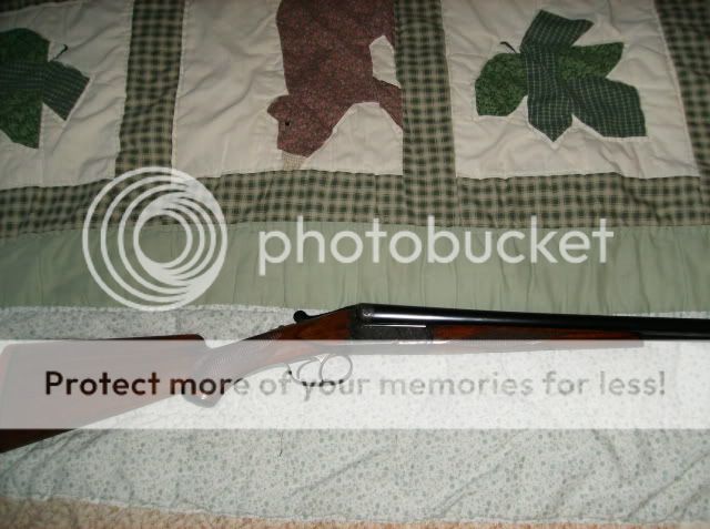

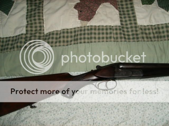

Here are some more pictures of gun#2. I could not get any good pictures of the proof marks but this is what was on each barrel flat;
16 than underneath that was 70mm and then under that was the letter N, this occured on both barrels but one barrel had some sort of crest and then the number 942 underneath the crest. My guess is it was made September of 1942. Can anyone help out with a value on this one?

Originally Posted By: Trappererick
The steel type stamp on these tubes looks like Heinrich Ehrhardt. Is there an encircled square that I see?
Joined: Jun 2012
Posts: 5
Joined: Jun 2012
Posts: 5
Ellenbr,
Yes it is just as you said square with a circle around it. On each barrel in a circle pattern are the words Ehrhard Lauf. Does the 631 on the forend mean it was made in June of 1931?
