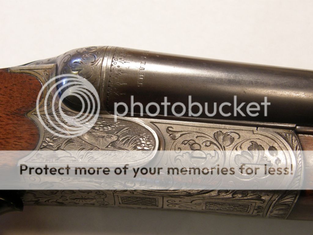

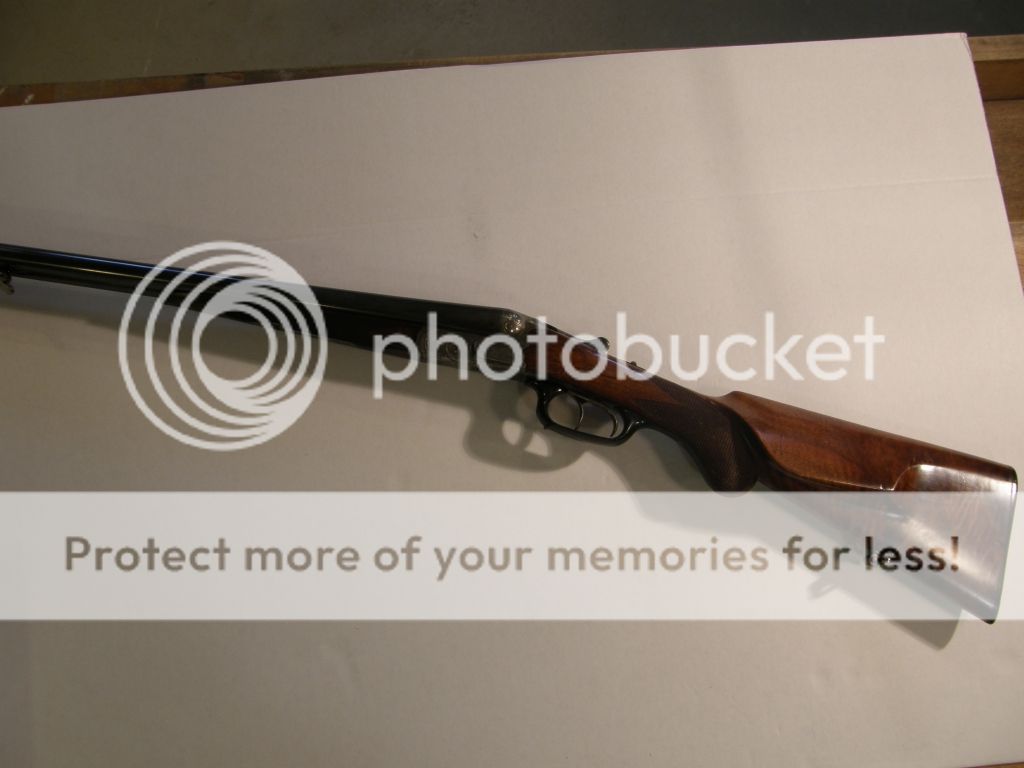

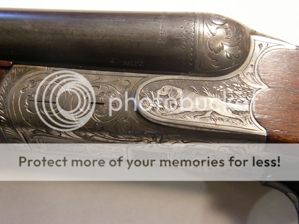

Hello all,
I have just looked at and taken some pictures of another gun from the collection I am selling for a friend. I believe the maker is Emil Eckholt or Eckhilt. 16ga. will send pics to Raimey to post if I'm not becomming too much of a pain.
Thanks, Harm
Harm #277271 05/05/12 03:35 PM
Posts: 12,668
Likes: 511
Posts: 12,668
Likes: 511
Indeed that is a homegrown Emil Eckoldt double with an Austrian or Bavarian style stock made between 1912 & 1923 in Suhl. More than likely a Blitz or triggerplate action.

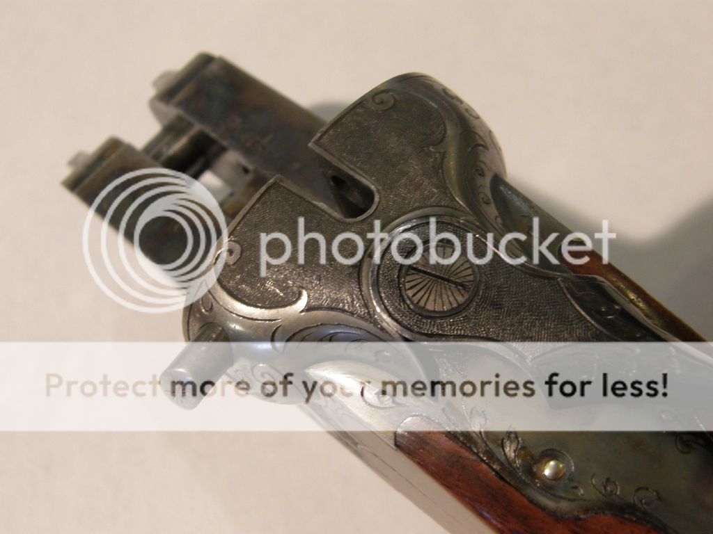

Wouldn't mind see a close-up of the side of the frame.

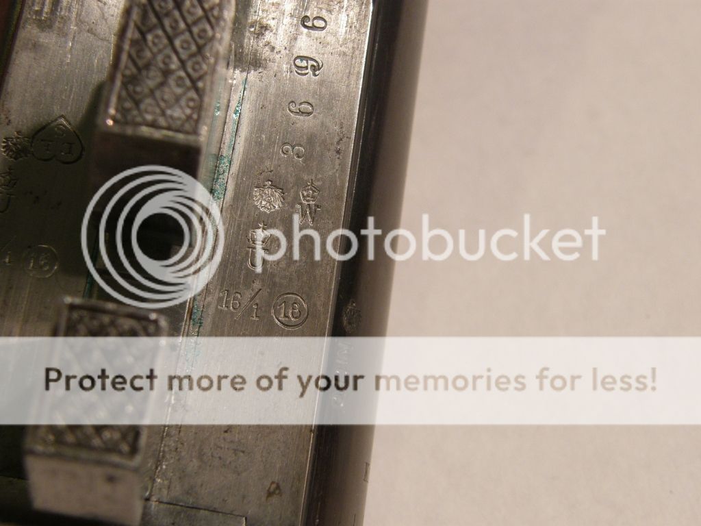

Could you send an image of the side of the frame?

I will do it now. Thanks, Harm

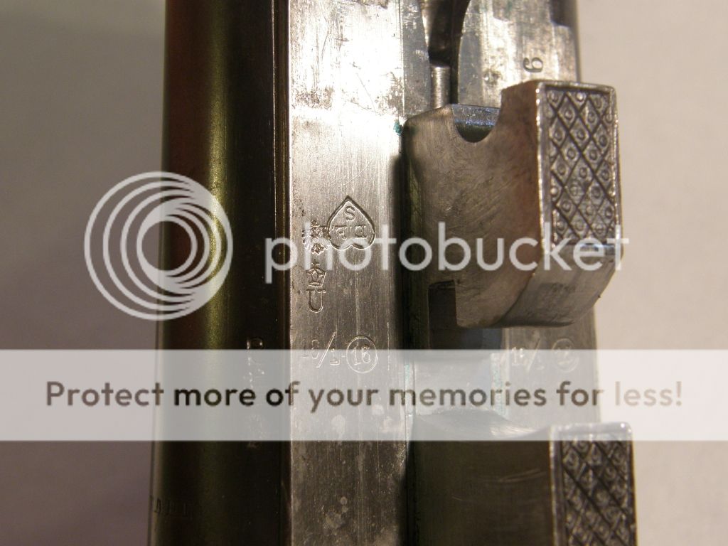

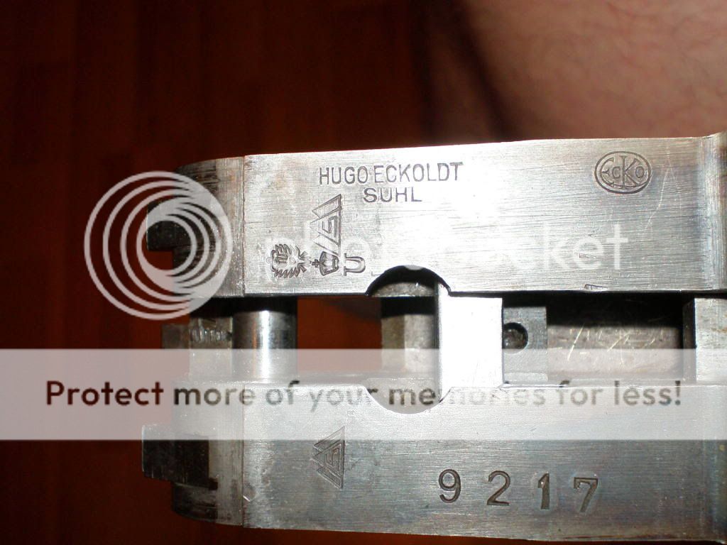

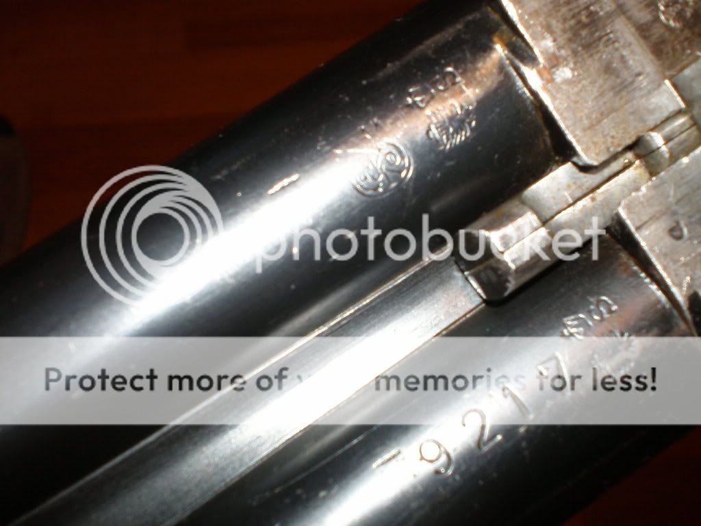

Me thinks the EES in a Heart was the mark of Emil Eckoldt, who hung out his gunmakers shingle in 1876. Later one sees the encircled ECKO more than likely being the mark of Hugo Eckoldt as below.
Yes, it does have Simson triangles and info sort of points to Edgar Strempel having a hoard of Simson components.
And as per this 1951 example, trading didn't cease in 1945.
