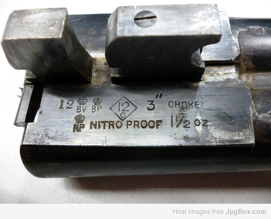

Thank you! Is the text "Specially built for 3-in cartridges shooting 1 1/2 ozs." or 1 1/4 ozs.? Were 1 1/2 oz. loads available in 1922?
Posts: 14
Posts: 14
These gun were proofed for 1 1/2 oz. loads.
Posts: 14
Posts: 14
An example
