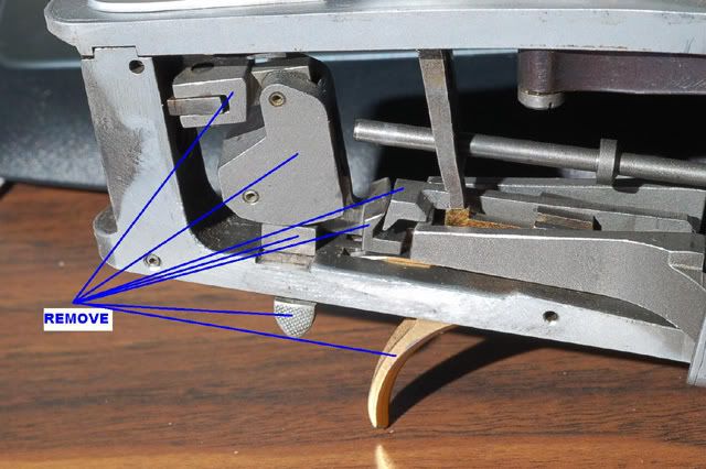

The BSS single trigger uses the floorplate that is configured for double triggers. You can see two blades of the single trigger going up into the floorplate.
Other designs like the Hunter One Trigger and the Parker also use a floorplate that still has the two slots for the double triggers. One slot has the single trigger and the other slot has the selector.

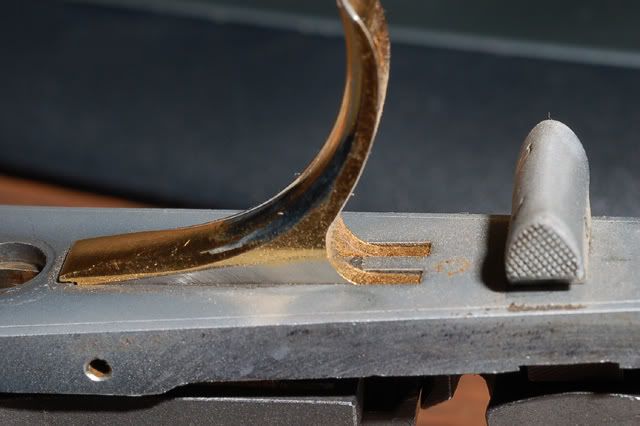

However, if you have a Miller or Miller copy (factory Ithaca), the floorplate will be a single wide slot. You would either have to replace the floorplate or weld a piece in to accomodate the triggers, as a minimum. There's also the issue of the sears. Look at the picture and you can see the bent sears to accomodate the single trigger mechanism. On double triggers, these would be straight.
So some guns are double trigger ready and some not.

On the BSS, it's a simple matter of removing a pile of parts and replacing with some double triggers. The single trigger was designed to fit into a gun setup for double triggers in production so they could go back and forth to each type without extreme modification of the basic frame, floorplate and sears.

Certainly how much a DT conversion costs to do is affected by many things. Since each single trigger design is different, there's no way to apply a sweeping statement about what it would take to convert all single trigger guns to DT. I have no idea what differences are in a single trigger H&H gun vs their DT. It could be very different on significant parts or it could be just like these American gun single trigger designs.
On a gun like that factory Ithaca single trigger shown in the second picture, it would require either replacing the floorplate or welding it up and either replacing the sears or straightening them. Also some safety parts would need to be added.
But for the most part, double triggers are about as simple as it gets.
