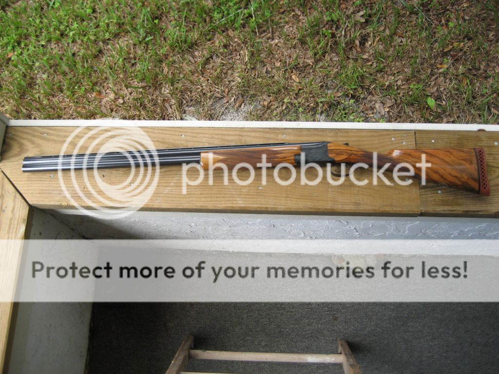

Mine is 3857 C, a 30", SST, straight stocked, horn butt plate, solid rib, F&F, w/twin ivory beads & border engraved. Gold filled FN on the top lever. Gold filled S. Selector on the trigger plate. Non-auto safety.

Devrep,
Pictures! now that's the way to respond! It also raises more questions though...like...it looks like your gun has a single selective trigger with O & U stamped on the top tang and the left/right lateral safety...but the low serial number suggests the gun was manufactured well before Val Browning applied for patent protection...I have never owned a double trigger superposed or a twin single trigger, so I don't really know what the top tang is supposed to look like on those models.
Under the supposition that FN produced about 2000 superposed shotguns per year for the first 8 years of production...yours appears to be a first or second year produced gun...so 1931 or 1932 but no record of superposed single triggers until Jun 25, 1936...
I clearly do not understand...perhaps the twin single trigger gun came with the lateral safety?...or maybe Browning produced single triggers well before applying for patent protection?...or maybe 1294 was re-fitted after 1936...

good morning Robert. the gun is 1931 production but was customized somewhere along the line, I do not have any info as to when.

I have gotten information on guns that early from the Browning historian. The trigger is a later retrofit. It is some shotgun.

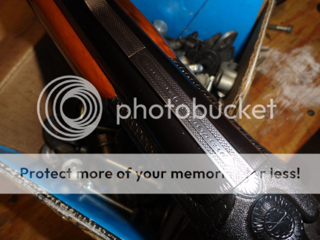

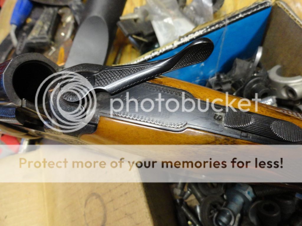

Fellows ,I stumbled onto this thread, as old as it is, and thought I would add some info about three of my prewar Supers. The first is S/N 81P, which indicates a trap model ( S suffix denotes a field model), with 30" hollow solid rib with double ivories and choked M/F. This gun had the Marlin factory collection tag when I obtained it. It has no FN engraving on toplever and is not a monoblock model, true double triggers, frame is engraved like the Superlights from the 1970's. Very nicely grained French walnut semi PG stock to old FN double ring horn buttplate. (2) The second Super is S/N 1281, a monoblocked 32" vent rib barreled gun w/ double ivories, w/ no choke designations stamped at breech end, SPG stock and old horseshoe forend, also with frame engraving like the later Superlights, and true double triggers. (3) Lastly, there is a 'Lightweight' pre-Lightning S/N 7146, w/ 26" ribless barrels, stamped IC/IC chokes, wgt. 6lbs.10 ozs., 0.013" choke constriction in both bbls., nice straight grained French walnut SPG stock with rounded forend, first style selective ST w/ selector beside trigger ( marked T & B). Anyway, I just wanted to add my information to the mix. Also, I have a question; can a postwar buttstock be used on a prewar gun if the later long drawbolt is used? Thanks, Sandlapper
