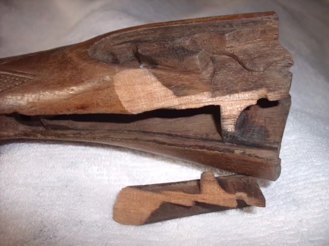

Take the whole thing apart. I'm not a fan of drilling a hole in the stock after my custom clamp slipped just a bit and did this:

Fishnfowler, looking at your picture it looks that the side plate was not on when this happened. That is why the jaw pad is on the clamp in my picture so that can't happen.
