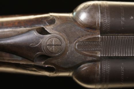

Has anyone come across one of these before - sleek little gun:
J.P. Sauer Triggerplate Round Action, action engraved "J.P. Sauer & Son" on both sides, barrel tubes both engraved "J.P. Sauer & Son" and Krupp Steel", action water table engraved "Made in Prussia", 16 bore, 2 5/8" chambers, 26" barrels, extractor, double triggers, Greener cross-bolt, concave game rib with machine stamp pattern, top mount tang safety, weighs just over 6lbs, seller thinks it was made around 1905.

Impressive sleuthing, Raimey. That is an interesting action design. With the trigger acting as the hammer sear, I would imagine the trigger pulls should be very crisp. But it looks like the mainspring is attached to the barrel lump, so how do you break the gun down?
It looks like there is a small projection coming through the trigger plate ahead of the trigger in the diagram - this would match a similar projection shown in the photo.
