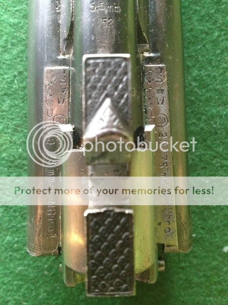

Some images of a Georg Knaak Berlin were kindly sent to me this week. Max Meffert acquired the business in 1907, so I'm curious if Max Meffert had married Georg Knaak's daughter or if there was some other family relationship there. But the main reason for the effort is the 75mm chambers found on this Blitz action and an August Jung 16 bore with 75mm chambers. I realize that one is a 20 bore and the other a 16. Would the Georg Knaak be considered an off-season sporting arm?

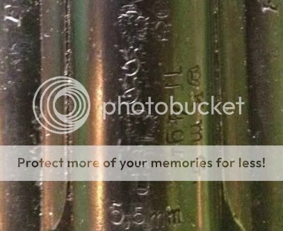

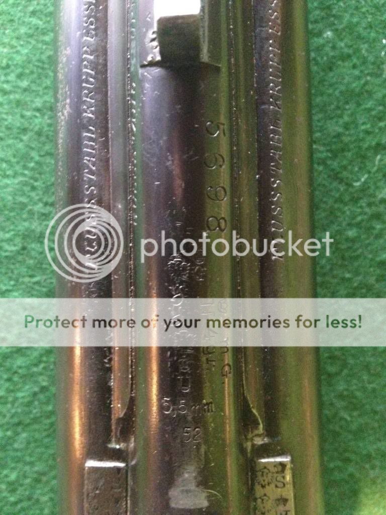

Note the YJ, or some variant, tube makers stamp. I wonder if the craftsman was actually a Jung out of Zella-Mehlis?

The Knaak drilling first: The gun was made and proofed in Suhl post-1912. No, it cannot be considered an off-season arm, as it's rifle barrel is proofed for a cartridge considered a "serious big-game load" by some around WW1, even popular today for roe deer shooting. The markings 5.5mm bore diam., 52mm case length and 4 gramm copper jacket bullet show it to be a 5.6x52R aka .22 Savage High Power. A family relationship Knaak/Max Meffert is not known, but both gundealers were near neighbors in Berlin, Friedrichstrasse. In 1910 after a settlement M.Meffert's business was amalgamated into "Deutsche Waffenfabrik Georg Knaak", already owned by Max Meffert since 1908. Also in 1910 the company was bankrupt, but it continued under obscure ownership and management at least to 1941. Despite the designation Waffenfabrik = arms factory it is very doubtful if they ever actually made any guns, they were sort of international dealers in all kinds of arms , ammo and military equipment, so the drilling was probably made for export.
The Jung drilling in 7x57R and 16/75 was proofed in Zella-Mehlis October 1939, so it was made by the Z-M guntrade. There are 17 "Jung" listed in Suhl, 4 in Zella-Mehlis, 3 in Viernau, a village about 8km west of Zella-Mehlis, and 6 more elsewhere in Germany. The only August Jung was one of the Viernau Jungs, so he certainly was part of the Zella-Mehlis trade. In which way he was related to the other Jungs is unknown to me.

Axel thanks for the insight so can you comment on the 75mm chambers? I didn't mention it, and I don't know if you noticed the date-code, but it is something like 8/26.
I've just glanced at the tubemaker's dual stamps, but they appear to be those of Wilhelm Kelber but there may be something amiss as either they were applied off-center or worn?? If not Wilhelm Kelber, then yet another variable.
You are correct on the Viernau as the location and I didn't realize it was so close to Zella Sankt Blasii, Mehlis & Suhl.

Can either of you comment on the 16x20 ga? I am baffeled. I have s few 20 ga combo guns and am wondering why the 16x20 shotgun combination? I could understand a 20x20 combination.

It may be I that has led to your being baffled. Neither are mixed in bore and I don't think the tube relationship or even barrel harmonic would gee-haw. Have to ponder on it then inquire to Mike Ford.
