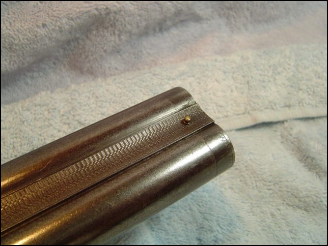

One of his more interesting uses of the mono-block was the Diana grade. The block was fluid steel, the tubes damascus with a band of fluid at the muzzles.
http://pictures.auctionarms.com/3575184557/63989a6945e3abe0080b59ea4af8098b.jpg?aa=20070123060143
http://pictures.auctionarms.com/3575184557/b3774d68baa0daee3356ae2e146322f1.jpg?aa=20070123060143
Posts: 12,743
Posts: 12,743
Note that guns built like this follow the original 1881 patent design. On these the breech piece is bored through on a slight taper & the tubes inserted from the rear. This is the reason for the step at the end of the block. On some later models the block was threaded part way through from the front & the tubes had a section turned & threaded to screw in, but extended only about half way through the block. These do not have the step at end of block but a smooth transition as in modern mono-block guns. Somes guns constructed as the one in Pete's ref are marked "Original Diana" while one I have of the screw-in type is marked "Modified Diana". I am however unsure if this is consistent with the construction method, or is a grade marking. The Modified Diana guns I have seen do not seem to be as high a grade as the Originl Diana.

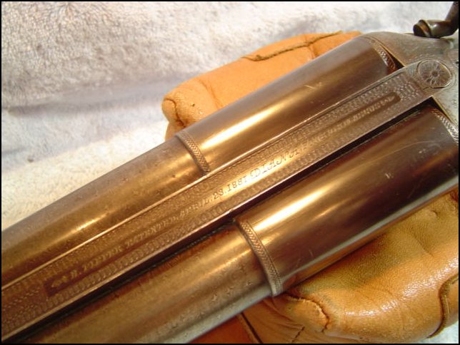

Here is the original patent version:
Here is the modified version:
You can see the date on rib of the modified version is 1892. Here is the original patent:
http://www.google.com/patents?vid=USPAT2...er+1881#PPP2,M1
If he filed a another patent for the modified version, I can not locate it.
I have English and German Pieper reprints of catalogs. There were apparently grades within the Diana grade. The difference is the coverage of engraving and amount of gold inlay. Neither of the guns pictures are on the high end of those grades. Both of the examples pictured above show laminated tubes. The English catalog says the tubes are of Krupp's finest fluid compressed steel.
