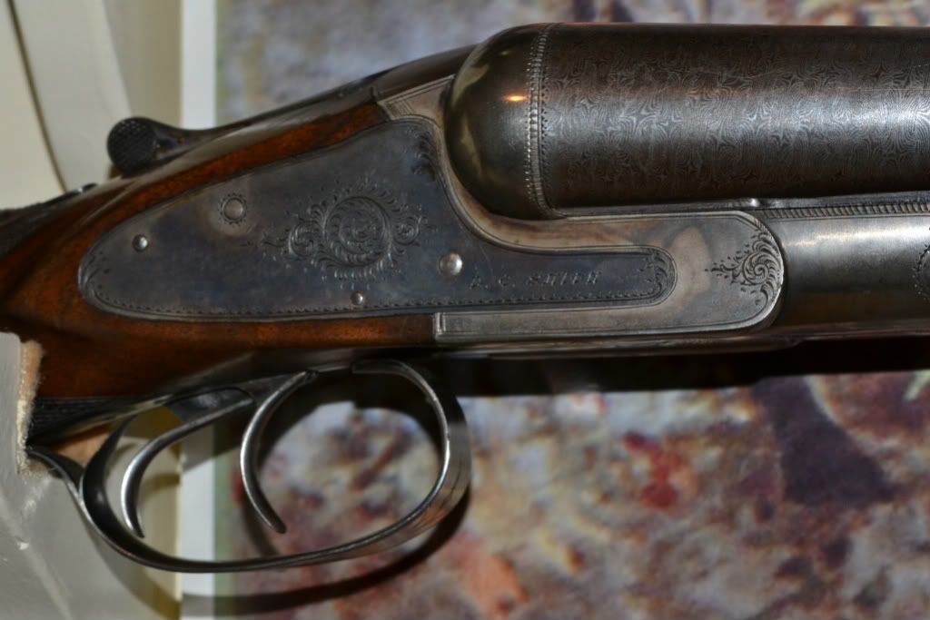

LC Smith 10ga fine damascus Syracuse era. Bores measure .790/.792, I believed honed. Wall at 3" L-.177, R-.168, at 9" L-.082, R- .086; Min. wall near muzzle before chokes L-.038, R- .046, Chokes .033/.035. 2 7/8" chambers. Plan on reloads in the 5000psi range?
Safe to shoot?
