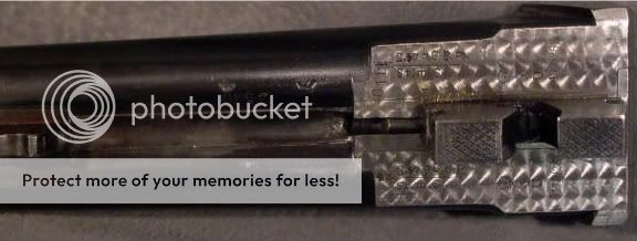

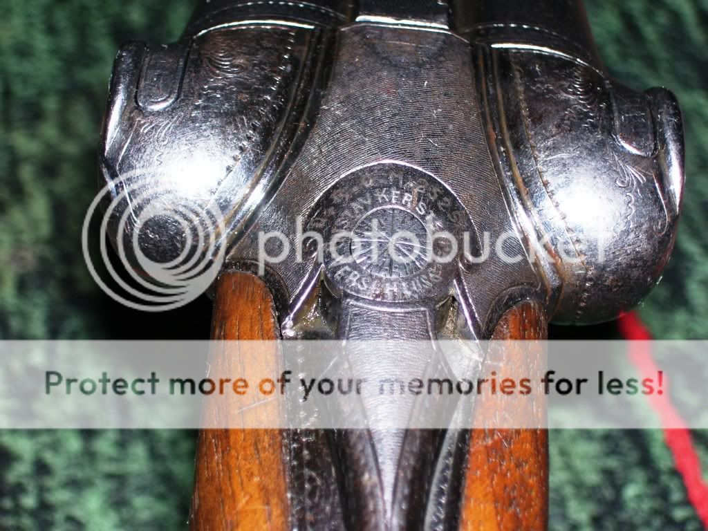

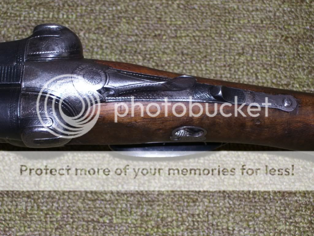

One of them had the same locks as pictured on the Germanguns site.
THe other more embelished one had a system similar to the SKB locks with a crossbolt. There were two knuckles where the barrel extensions would go in on a rather small frame otherwise.
Prices asked were 10K for one and 13 for the other.

The nicer one has the same action as the last one you pictured.
Thank you for all your help.
