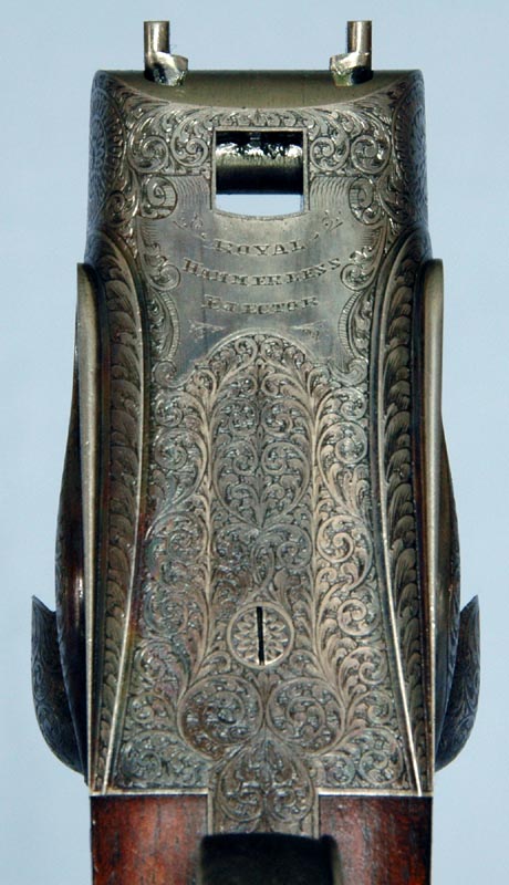

Quote:
Side question, can a gun not be considered best quality if an under lug protrudes through the bottom of the frame?
Holland and Holland wouldn't take that position.

But Purdey would---as they've never built one that did.

thanks for the response on the "best" guns... the gun in question was actually an Alexander Henry 12 gauge. I'll create another post with some pictures when I get time.
