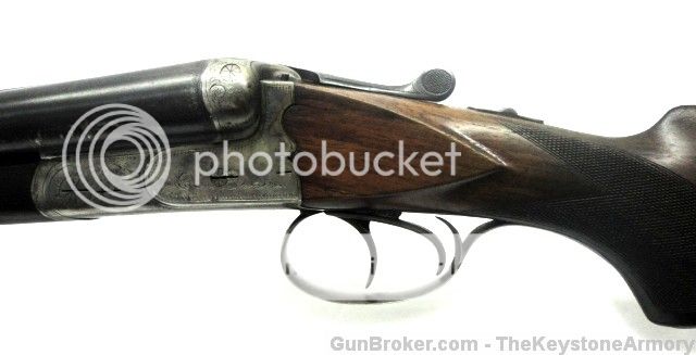

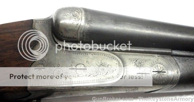

I acquired a Zella-proofed gun last week on Gunbroker and am unsure of the maker. It's a non-ejector with sideclips, scalloped receiver edge and cocking indicators.
http://www.gunbroker.com/Auction/ViewItem.aspx?Item=216892455

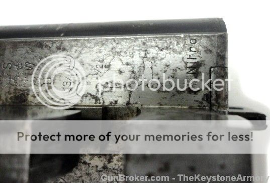

It has what appear to be both "August Schueler of Suhl" and "Sauer and Sohn" markings on the barrels.
And what appear to be typical proof marks.
It needs a minor stock repair and the checkering recut, a few scratches touched up, but otherwise it remains a tight, uncut and unbuggered, 6lb gun.

At a quick glance I'd say Schuler sourced a parts kit with the tubes being from Sauer and then subed the work to Franz Adamy for the bulk of the work. It was finished to the customers requests in the August Schuler shop. I think this reinforces the probabilty of post WWI Dalys actually being made by Gebruder Adamy and possibly with Schuler being the middle-man, which I'm still a bit leery. It defines a sourcing line independent of Daly.

Why do you think the gun was proofed in Zella? (the proofhouse was in Mehlis, but by 6/25 = June 1925 both towns were amalgamated into Zella-Mehlis anyhow. But, your gun was proofed in Suhl, as the word "NITRO" is in block letters. The Z-M proofhouse used script.
My mistake, thanks.

But those look to be 2 different actions. The frame is shorter and the lugs seem to be larger on the top pic and I'd guess it has both overhanging and intercepting scears or it may be a DR.
Can you give a measurement of the tube length? Since it doesn't have the menancing muzzle, I wonder about the overall length.

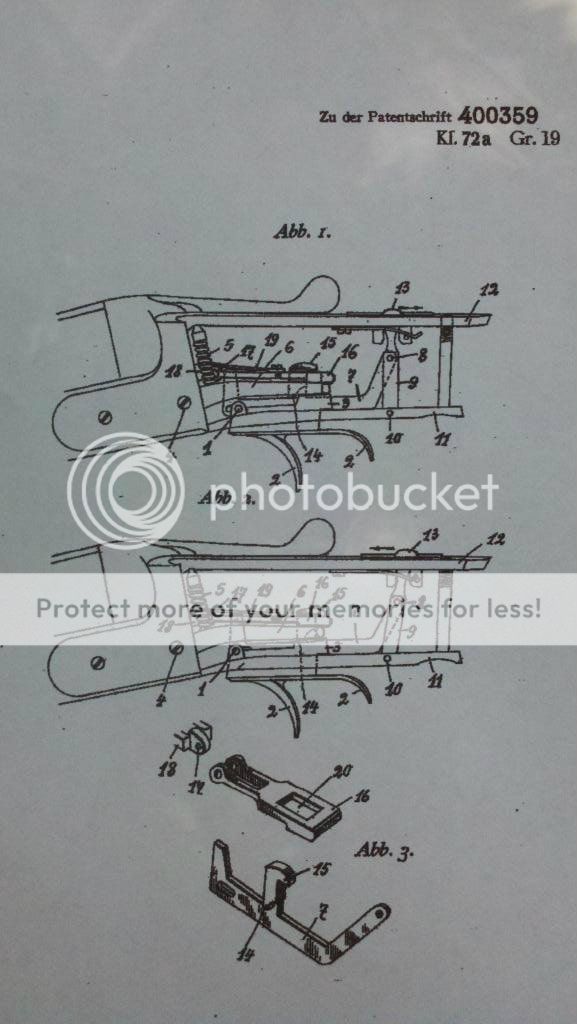

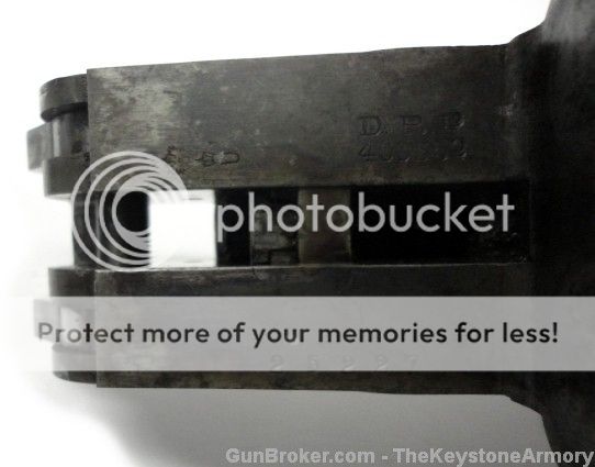

How about an October 1928 proofed double by ASS(August Schüler Suhl) utilizing Heinrich Barella's 1922 patent - Sicherungsvorrichtung fuer hahnlose Gewehre or safety device for hammerless sporting weapons?
http://www.gunbroker.com/Auction/ViewItem.aspx?Item=284097748
