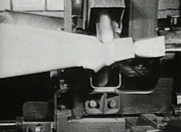

This is a "stock profiler machine" at work. 1922 in the Marlin factory.
While a rough profiling could be done, the stock department was mostly men working wood in jigs while belt sanders or cutting heads did the work.
I have seen similiar images of Belgian work during this time period.
