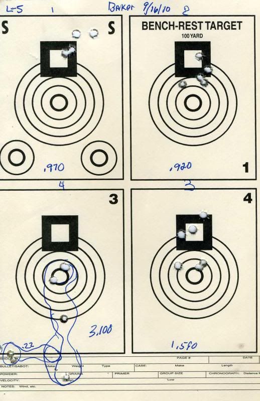

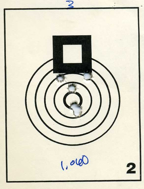

The weather has improved somewhat so I'm back to the rifle range.
On the 14th I was shooting the Niedner-Baker-Borchardt .25-Krag, the one with the cocking knob.
All the loads were the same except the seating depth of the bullet.
I fired a couple for foulers at another target then fired what you see here. All at 100 yards. Scope is about ten power Fecker that I have had for decades.
Look at No. 3 went to over three inches vertically, this is not from .010" of bullet seating. More to come.
Normally when I see that sort of stringing it's because I'm not resting the forearm in the same place.

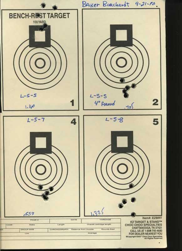

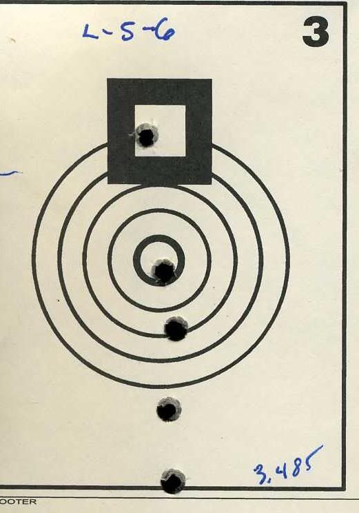

My rest is built for a forend stop for a bolt gun so I made a longer one that I could adjust for the Borchardt.
This is today, No 3 again??????????? No Wind, dead calm.

Had something similiar in a BR match once and the objective lense had came loose on my new Unertal scope. I would suspect the sighting system
Tom
Tom, I pulled the Fecker off and will try a Unertl I have, I'll report back.

Check to make sure the scope blocks are tight.

Mike, is there any possibility that your case necks are not sealing properly?
Bob
Thanks I did check them and they are tight. Just back from the range, first morning of frost..
Six five-shot groups at 100 yards average around .880". I fired one group off the barrel and that one vertical strung them out but not bad. I'll take it slow and change one thing at a time and see how it goes.
Originally Posted By: Schutzenbob
Mike, is there any possibility that your case necks are not sealing properly? Bob
Bob, Welcome to the forum, good to see you over here as I no longer post at the other place ;-). I will look forward to your post.
A good question,I have segregated any brass that seem a little tight and run it back through the Niedner die. This rifle chamber is cut so the cases are not re-sized. I de and recap with a Pope type re-decapper load powder and seat a bullet. I've been playing with the seating depth and resting the forearm at different places.
This rifle averages around 1-MOA and IMO it should be about half that, the work continues.
