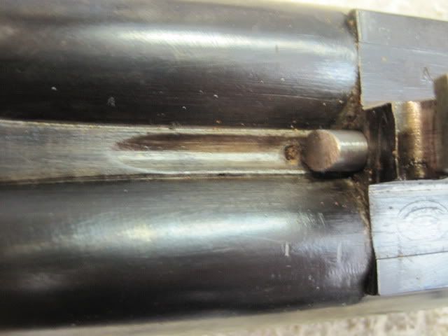

More likely marked for number three weight barrels, especially if marked on the barrels just in from of the flats. If it is a fairly light gun,under 7 1/2lb., almost for sure #3 weight barrels.

Now that I reread your statement, if the 3 is on the bottom of the barrel tubes forward of the flats, Steve is right and that is the indication of 3-weight barrels.

Here is a picture of the barrel flats on a 12 ga Fox with factory 3" chambers and # 1 weight barrels. Best I can tell the chambers do measure 2 7/8". Gun is not marked anywhere as being chambered for 3" shells.
If the # 3 you are referring to is in the same area then as Researcher and Steve state this stamping is for the weight of the barrels. Mike
