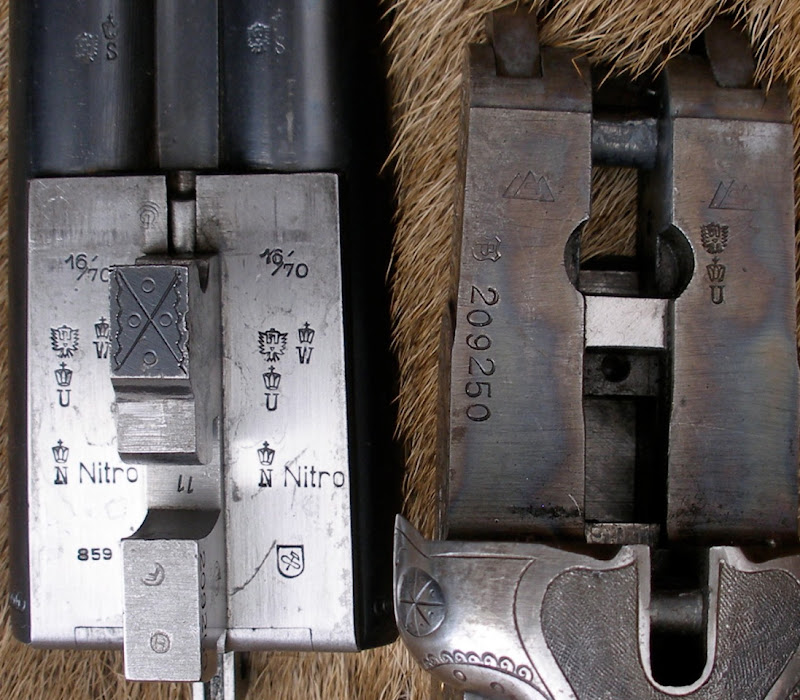

Hello Murphy,
Here is an example of an August 1959 vintage one:
Extremely well made and, as far as I have been able to see of DDR vintages, the same as a Merkel of the same era.

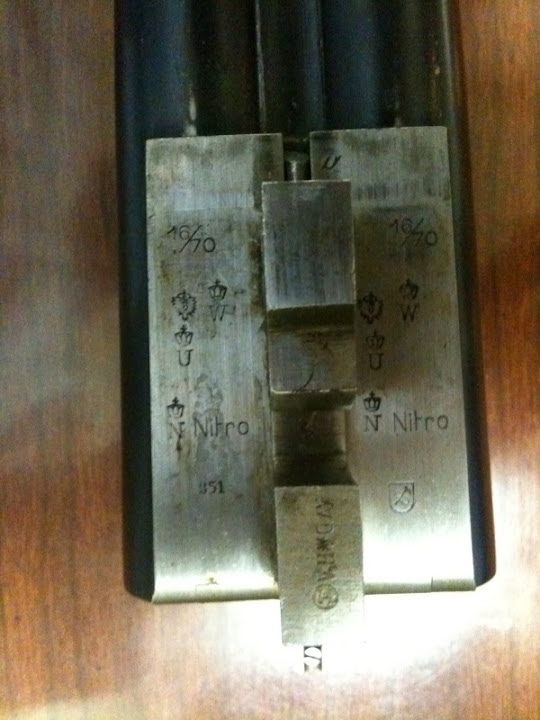

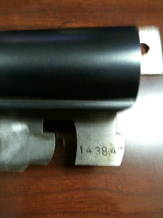

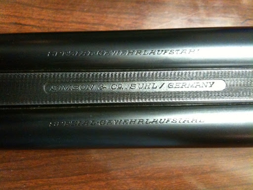

I picked up the gun today, serial number 143842 in 16 ga barrel flats has N Nitro with Crown over N also Crown over U and crown over W, 16/70 and number 851 which I assume is Aug. 51. I can email pictures if someone wants to post them. My choke ga. says cyl on both barrels. Top of barrel says Simson & Co. Suhl Germany.

There should be a number--3 or 4 digits--on the barrel flat. If it is 851, That would be August of '51. Barrels may have been cut if there is no choke but not necessarily, and who cares if it is the choke and barrel length you want? Chambers are 2 3/4" so it is a fairly modern gun, proofed for smokeless powder. These are good, solid, if fairly plain, guns.

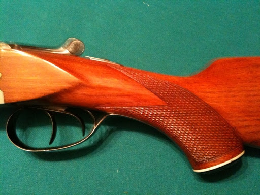

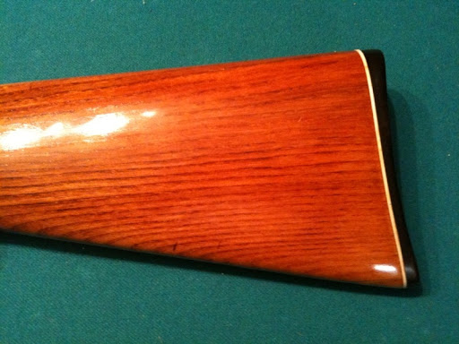

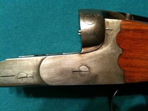

Murph, here are the pictures you sent:
And here is mine's receiver for your reference:
JC
P.S.: standard barrels are 70cm btw. jc

JayCee Thanks for posting the pic's Murphy

Interesting stamp(s) on the bottom of the rear lug. I'll have to stare at it a bit to possibly see it clearly. The example fits in the difficult post WWII period when components were drying up at the same time(1950-1951??) tube steel, and I'm sure other steel types, were beginning to be sourced from IZH: http://www.doublegunshop.com/forums/ubbthreads.php?ubb=showflat&Number=172670&page=2 .
I'm not sure at a best guess of approximately what serial number for Simsom/Thälmann(Ernst Thälmann VEB-Nationalization(1958/1959)/etc. when one starts to see the Russian Spezial Gewehrlaufstahl or weapons tube steel. Any interesting stamps between the flats and the forend lug?
