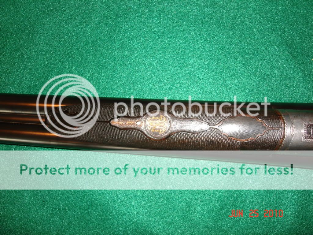

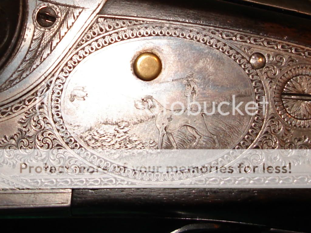

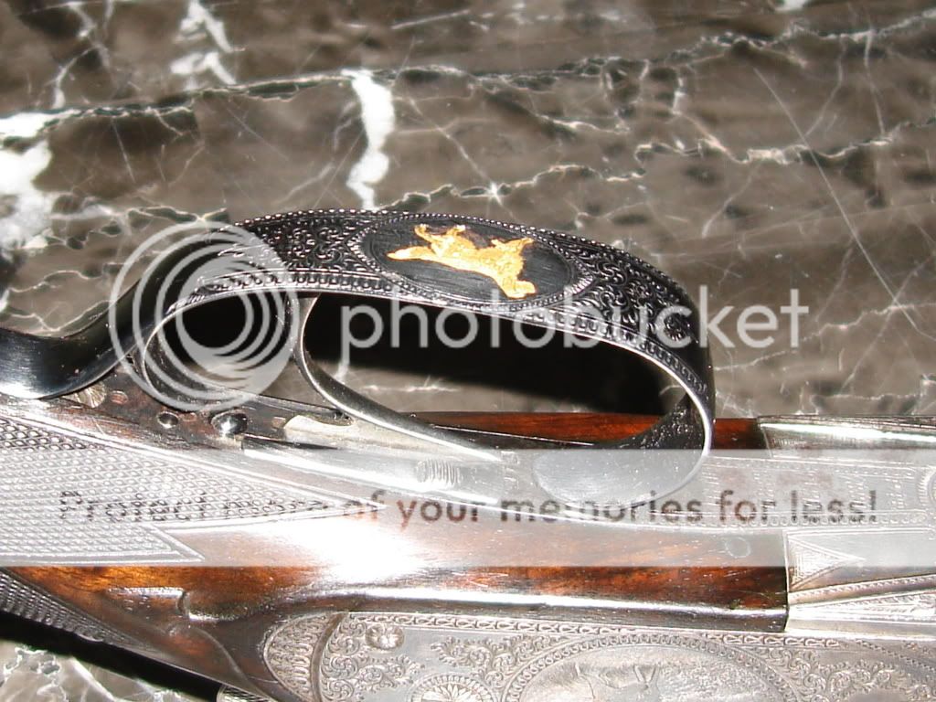

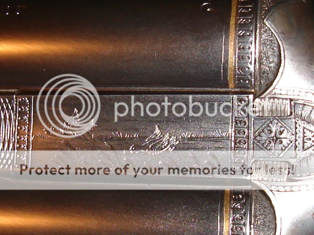

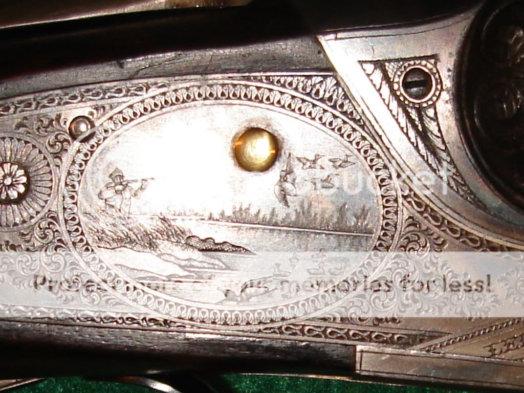

Can anyone tell me if Lefever had a single selective trigger or is this an after market trigger?

Yes, single triggers were optional on later production Lefever double guns; and Dan Lefever also offer single triggers on his DM Lefever boxlock models. That looks like a real nice high-grade Lefever there. As to the Lefever single trigger itself, I've heard they can be problematic; but am not a gunsmith, and therefore cannot speak to those alledged issues. The only Lefever single trigger gun I've owned was on a DM Lefever; which trigger worked great more the most part, only doubling on one ocassion. The biggest problem with that DM Lefever gun was the auto ejector mechanism, which never worked properly; but the in-frame ejector mechanism on side plate models as pictured above are extremely reliable.

Thank you, topgun, for the information. This gun was made in 1893 I believe it might have been sent back to the factory and had this trigger installed, however I am not sure. Also, the gun has inframe ejectors in it. If you have any other information regarding triggers on the Lefever guns please let me know. Do you happen to know if Lefever installed single select triggers after the guns were built and left the factory?

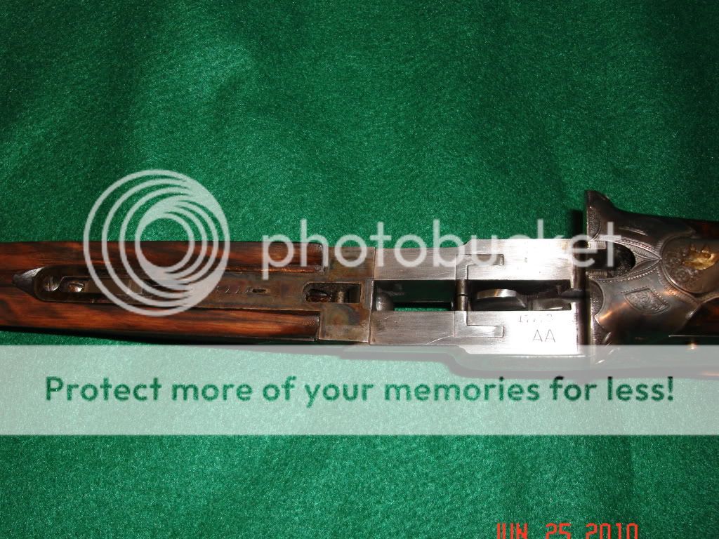

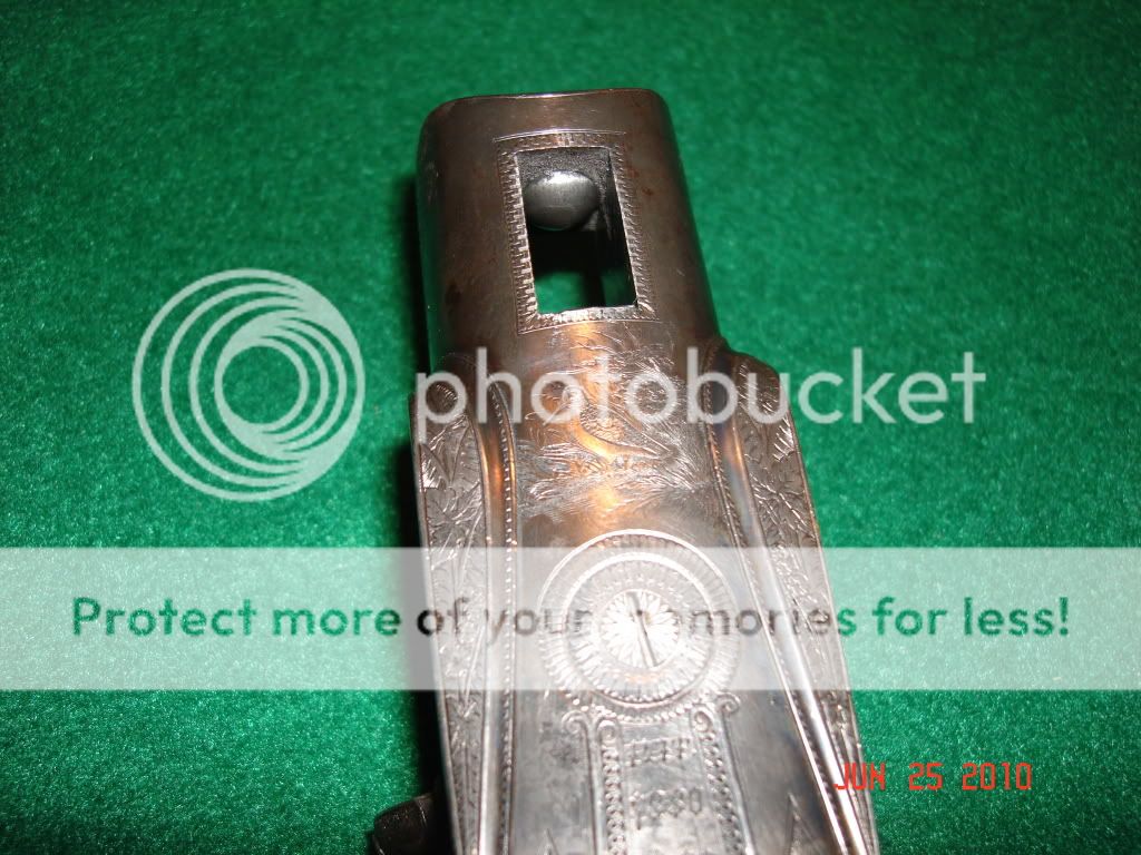

When you say early, what is the serial number? Lefever Arms was notorious for not building guns in numerical sequence; so finding low serial numbers with later features and vice versa is not uncommon. I suggest you post additional pics to help make a period determination (be sure to show the cocking mechanism); but to answer your question, I'm sure Lefever would have installed a single trigger in an earlier gun on customer request, as it seems there was little that company couldn't do in the way of custom work.

Topgun the serial number is 17773

Obviously this gun has been around; and hopefully Richard can shed a bit more light. As regards your question about it's single trigger; this gun has all the later features such as large cocking hook and late style top fastener that would be consistent with Lefever guns seen with a single trigger, and the in-frame ejectors certainly look to be factory original work. Several years ago I saw a very similar AA Grade Lefever in Charlotte, NC; and as I recall it's number was also in the 17XXX range. I don't remember if that Lefever had a single trigger, but the engraving on that gun was very similar to your example.
