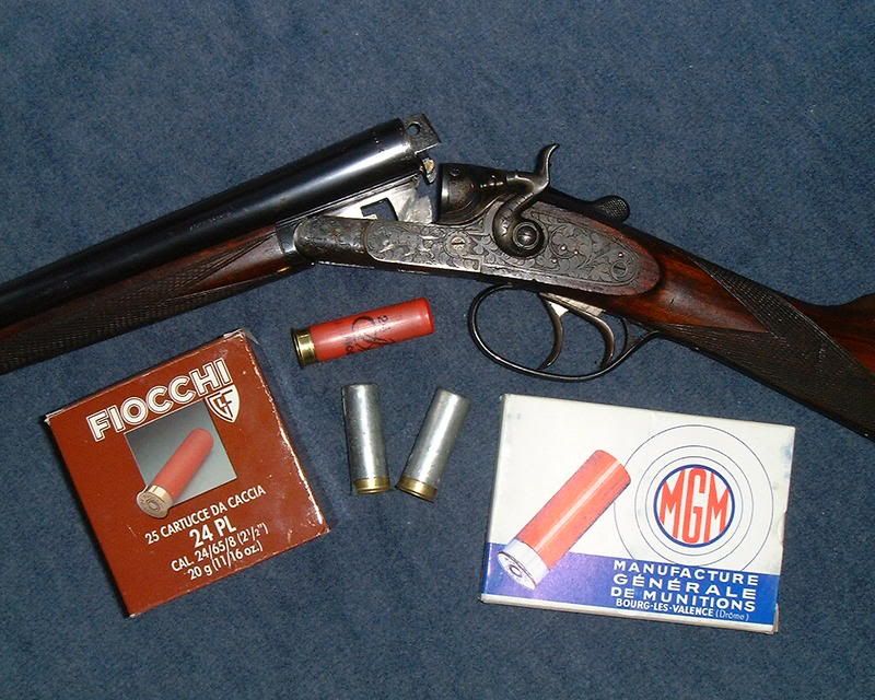

We could start a Bayard club! Here's my contribution; my 24 bore:
