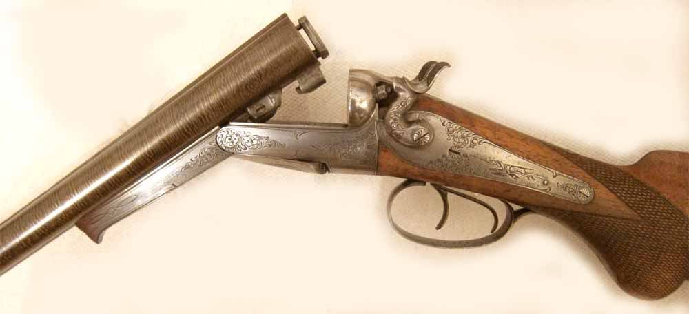

I own a few very nice Damascus/Twist shotguns that have been professionally refinished and are quite attractive.
The other day I looked at a $300 damascus "beater" that isn't worth investing several hundred $$$ into refinishing. Is there an inexpensive lower-quality alternative to show some of the damascus figure. Cold blue? Cold browning? Any special technique?
