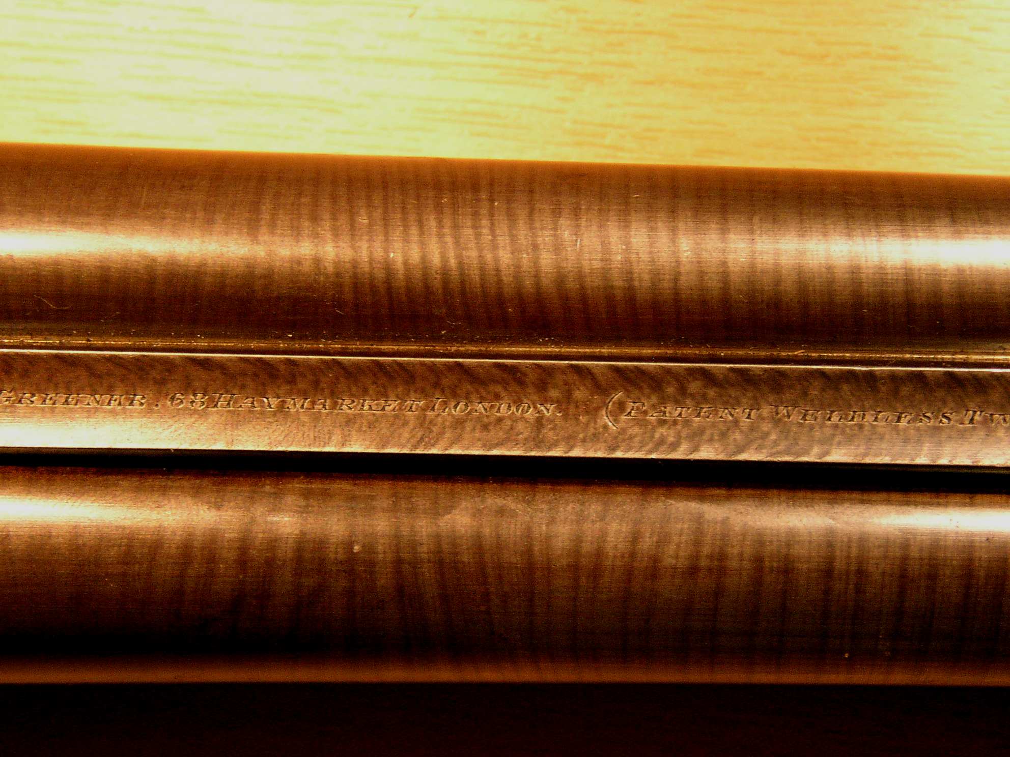

I collect orphaned Damascus barrels for various reasons and recently I found a nice set of Greener tubes with an unusual twist pattern. On closer inspection I found them to be engraved as 'Patent Weldless Twist' and the gun was numbered 20205 which places it in about 1879.
Looking in 'The Gun and its Development' by WW Greener in chapter 10 he describes the process and illustrates it with an engraving.
It is interesting as instead of being formed as a coil around a mandrel, it is formed out of a solid bar and then bored out. This results in no 'greys' and, he claims, a denser core which lends itself to rifling.
Sorry about the poor picture but here it is:
I thought this might be of interest to the Damascus enthusiasts out there!

In 50 years of collecting I have only seen/owned one Greener gun with Weldless twist barrels. This was gun #59039, grade D13, Made in 1911. This gun is one of Greener,s inexpensive grade guns retailing for 13 Gns;[13 pounds 13 shillings].I was surprised to find Weldless twist barrels on A D13 because I would have thought that they would have been more expensive to make than conventional damascus. The gun was a 12G non-ejector with 30 inch Barrels, Birmingham nitro proof for 1 1/4 ozs, loads.

I have no idea how many may have been made but US patent #9,999 was issued to Thomas Warner, Chicopee, MA Sept 6, 1853 for a process of making "Twist" bbls very similar to this. According to his claims he took a solid bar, heated it, then twisted it like twisting a rope, to the desired abount of twist. It was then "Upset" end to end for compaction, after which it was bored to caliber, & finished to proper shape on the outside. This would definitely fit the description of a "Weldless Twist".

In reviewing your excellent picture of the Weldless twist barrels,it appears as though the barrel blanks were twisted from both ends[ie: gives the impression of a left and right hand twist that meet in the approximate centre of the barrel]!The example that I once owned had a continuous twist in one direction through out the length of the barrel.The resultant pattern,was as seen, on page 243 of Greener,s book, "The Gun." I was unable to find a reference to, Weldless twist barrels in Graham Greeners book,"The Greener Story." I wonder if a Greener patent exists, or was Greener producing/using barrels under licence based on the U.S.A.patent mentioned in an earlier post?

Figiel, himself an avid collector, has documented some of the early methods of forming damascus that were used in India. They often involved twisting bars, cutting them and rejoining, etc. They created patterns that we rarely see. It was the Ottoman focus on economy that resulting in wrapping around a mandrel. This was adopted by Europeans.
The issue with twisting a bar is that more metal is lost during the boring.
