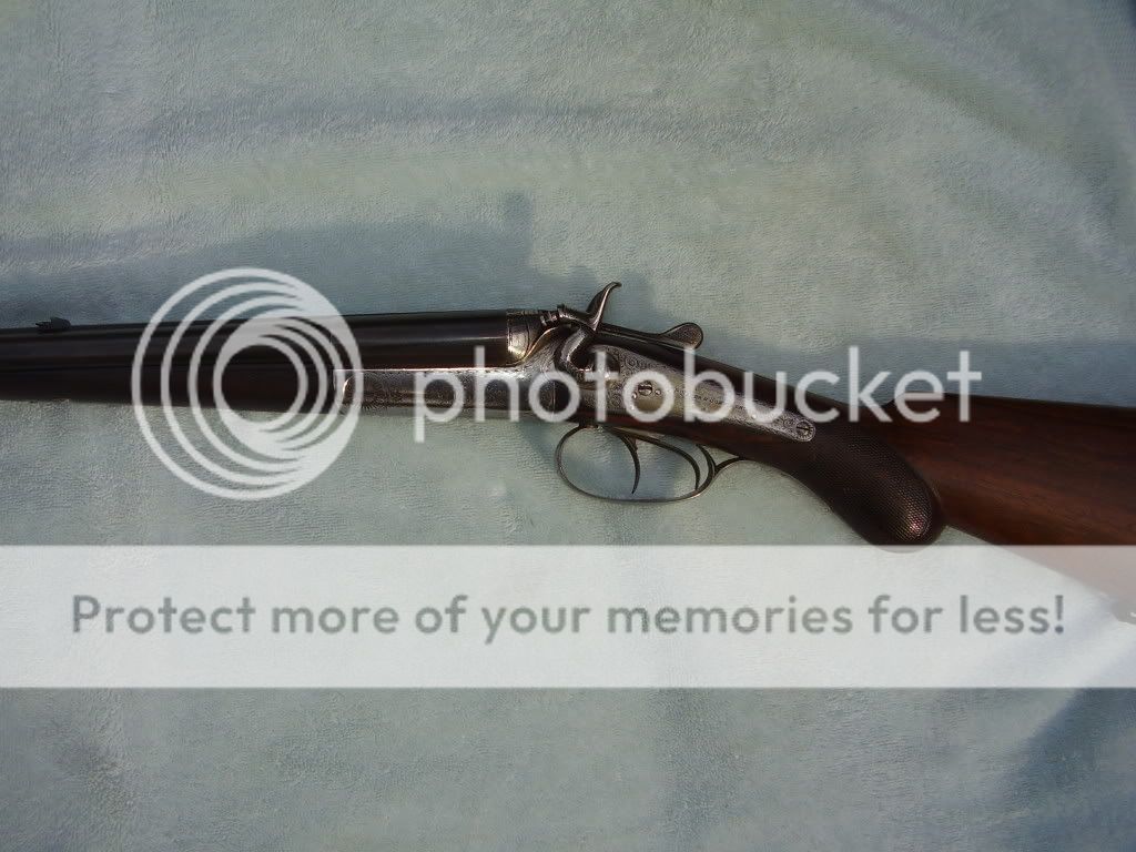

Here's Mr. Emery's Sauer DR for comparision:
Glad to do it Jani and I hope I can add more.
