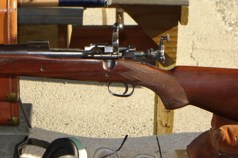

I've used the 103 on several rifles and never had any problems just need to remember this is a hunting sight and not a target sight. I put one on my heavy barreled Niedner 06 and it shot about a good as with the 48. For fun can you tell me who checkered the Niedner?

As a matter of fact I was so worried about my eyesight that I installed a Lyman receiver sight. The eye poking sight is in the drawer. I also have one on a Niedner Krag but that don't kick so much. .25 Krag

The scratches on the bolt look like Niedners work.
gbehrman
gbehrman #170877 12/19/09 05:08 PM
Yes, all the metal work is by Niedner.

Shellhammer?
mtman623 #223595 03/28/11 04:09 PM
Originally Posted By: mtman623
Shellhammer?
James V. Howe.
