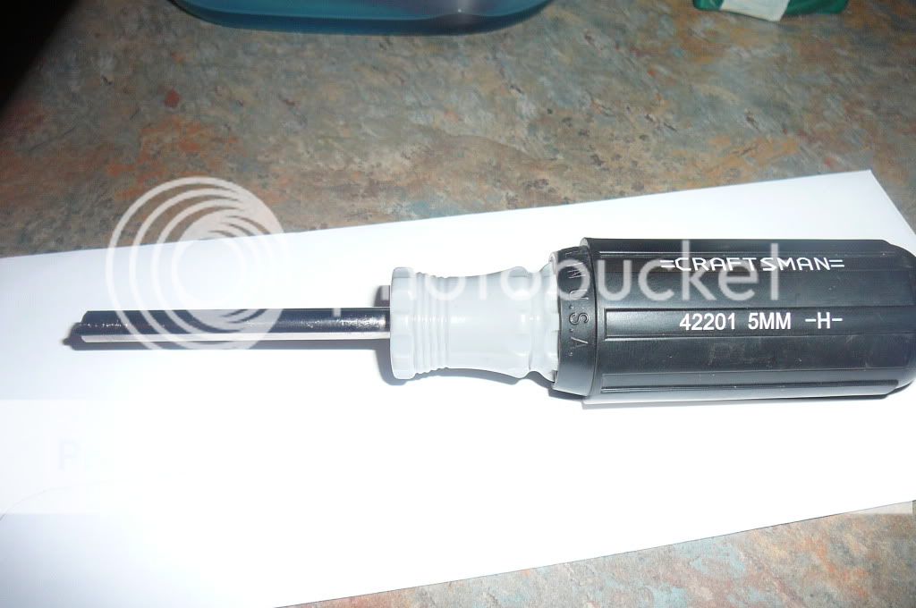

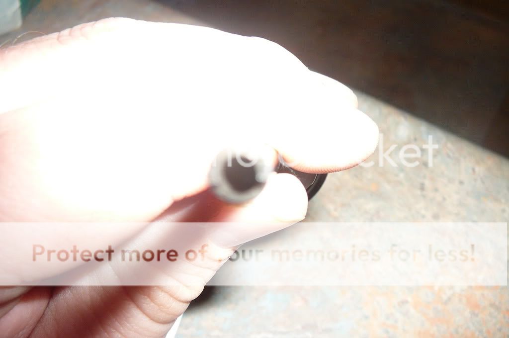

Take a 6mm nut driver and cut the end off, the shaft should be hollow and notch the opposing sides to fit the nut. There are 2 nuts.

Here is the tool I made and sorry it is a 5mm nut driver.
