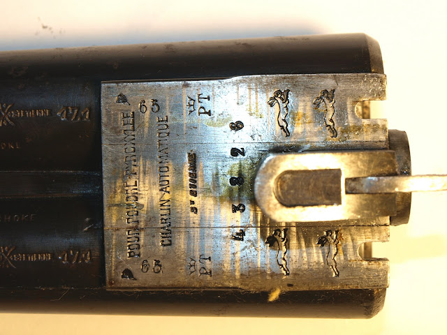

JC's photo shows what Larry mentions--the "palms" on the barrels fwd of flats. JC's has rabbit and all his friends and relations. What are the striations on the flats, JC. Looks like cyanide casing.

Mine has stars but no rabbits, "poudre T" proof and, in the second photo, a grove of palms.
jack

Bonjour Lapin,
Sorry for the mix up. The photo I posted is of the gun in question, not mine.
It should be yours btw. What with all those rabbits (they look like VS's hares).
My French sliding breech is a well ornamented Halifax.
JC

"Each...CHARLIN will be defined by a letter, and in the series, depending on the finish by a symbol of identification. Each model and thus each letter is associated with one of these 6 symbols: a rabbit, a tiger head, a swallow, a hare, a pigeon and a star.
Depending on the degree of finish, the number of these icons vary from 1 to 8."
I cut and pasted(stole?)the above. It means that the more critters stamped on the barrel flats the higher the grade.

They do remind of Sarasqueta, JC. Not mine however, as I have just the stars. You may have saved the pix of another Charlin fancier. I'd like to see how one distinguishes between rabbit and hare with a pictogram, Peter? I thought four bunnies was crowding things a bit--but 8?
I assume my 12 ga. with the stars is a "field grade" as the action and breech block are unengraved and case colored. Don't have vast experience with Charlins but think the built-in castoff of the comb on mine is a very distinctive feature. Almost a "recurve" in the comb area similar in plan to a trapshooter's cheek nest but not at all quick and dirty. Very different approach and result from cast bent in at the wrist. Saw this again recently on the Merkel 200e I bought in Hanover PA. Probably everyone here knows or knows of Ken Buch as an importer. I commented on the cast effect of the Merkel comb moved to the right off the plan centerline and Ken replied that he didn't believe Merkel built guns with stocks compensated in this fashion. Ken is a great guy BHCBW.

The funny Charlin thing is, there doesn't seem to be any consistancy with amount of running bunnies/stars/swallows to grade of gun. I have seen top notch, highly engraved examples that have one bunny, and plain guns that have what seems like a dozen. I have noticed that more fauna seems to be usual on guns with higher levels of proof. My own 16 gauge Charlin had zip, zero, nada grade markings on the flats, just a cryptic LC1. I have several Charlin catalogs that make little to no mention of markings on the flats, but, these catalogs illustrate "Art Deco" era guns, some of them beautifully engraved with almost a Celtic style of engraving. And, I have never seen a Charlin so decorated. Which, is too bad.
