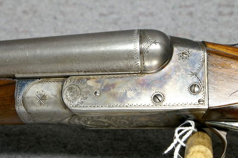

It should also be stamped on the gun. For instance this is a grade 3 Crass.
All 3 of these are Crass guns.

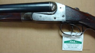

ok i found a picture of what the gun looks like on gunsamerica. this is not the actual gun im looking into buying. i dont know whos gun this is and im very sorry if there is a problem with me posting this photo on this site.
the gun is listed as an ithaca hammerless and the gun im looking into looks just like this one except for the fluid steel barrels.

You've got a Lewis model. Barrel roll engraving should read Nitro Proof Steel. Made from about 1900-1905 if I recall correctly. Very similar to the Crass mechanically. Next model, the Minier, went to coil mainsprings.

limapapa the gun in that picture is not the one im after. it looks just like it only the gun im looking into buying has damascus barrels very similar to the pattern on those in the first picture of the crass guns further up in the post.
could the gun im looking into buying be a lewis model with damacus barrels?. im going to the gun club sunday to shoot hopefully the owner will have it with him or provide me with an email where i can get pictures of the actual gun.
