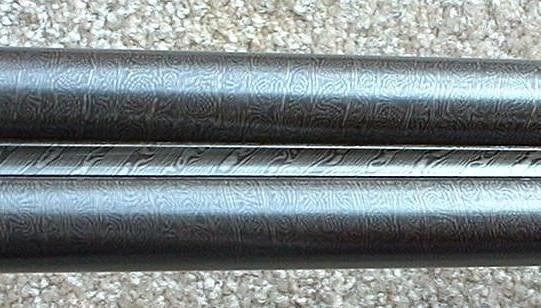

BTW: Nice Bernard pattern on those barrels http://docs.google.com/Doc?id=dfg2hmx7_108gj6wxpcf

Those barrels were very expensive. They don't show up well in the photos, but they are Bernard damascus. I had to reduce them so Photobucket would accept the file size. Top of the line available in Belgium.
This is a price list from Ferdinand Drissen, 1898.
Bernard damascus
I believe Raimey is correct. The barrel tubes were sources in Belgium and the gun was made in Austria.
