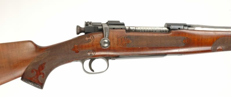

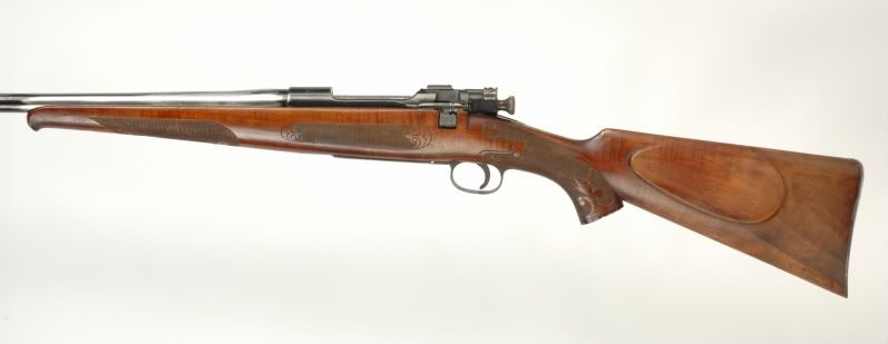

John Dubiel made a lot of stocks when he worked for Hoffman Arms. After he went out on his own his rifles are hard to find. This rifle had the typical scope job. The front and rear receiver were drilled & taped for a scope the bolt handle was both bent and ground off on the top. The Lyman 48 was removed and a piece of wood that went across where the bolt went was glued in. The wood was ten cut out for the bolt, I don't remember if the receiver was ground down as well. If this was not bad enough they then mounted a whiteline recoil pad. The only wood refinish was done around the Lyman 48 and bolt. The work was done by Monte Mandarino, MT.

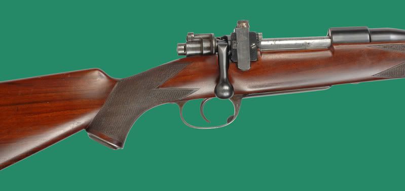

This is a rifle from an unknown maker and not the best work in the world. It has an engraved floorplate with the owners name and nice buttplate and long-slide 48. When I removed the electrical tape and pulled the piece of flat bar inletted into the side out the stock fell into two pieces. This was not a rifle I could justify spending any money on so I did the work. There was also a piece of wood missing from the toe of the stock. I made a mistake when I inletted the wood into the side I should have rounded off both ends and not left them square, it would have blended in much better.

I rather like the "Unknown Maker" rifle's lines. I think it's what Amber(?) used to call a "good citizen" rifle. Not the best but better than factory and showing some craftsmanship and character. A worthy rifle for restoration. It would be interesting to know its history.
