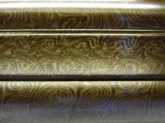

Drew, That is not my CE-Grade Remington. I think you are using a picture of the Chain J Damascus barrels on my early BE-Grade Grade Remington in your Damascus Picture Trail.

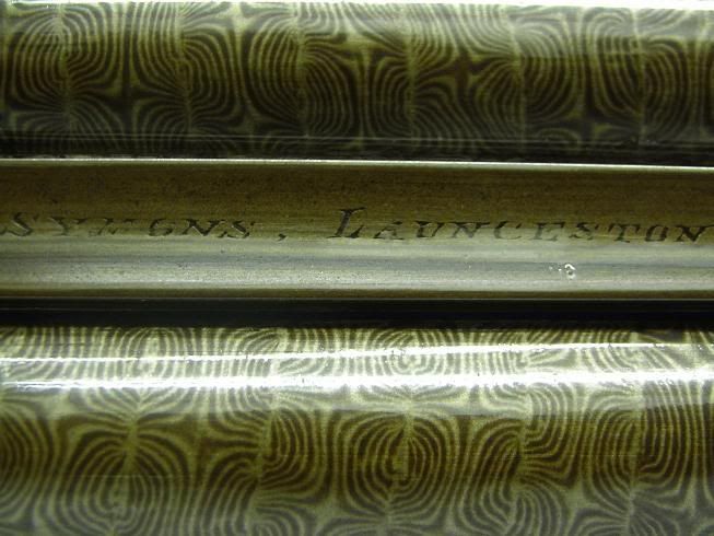

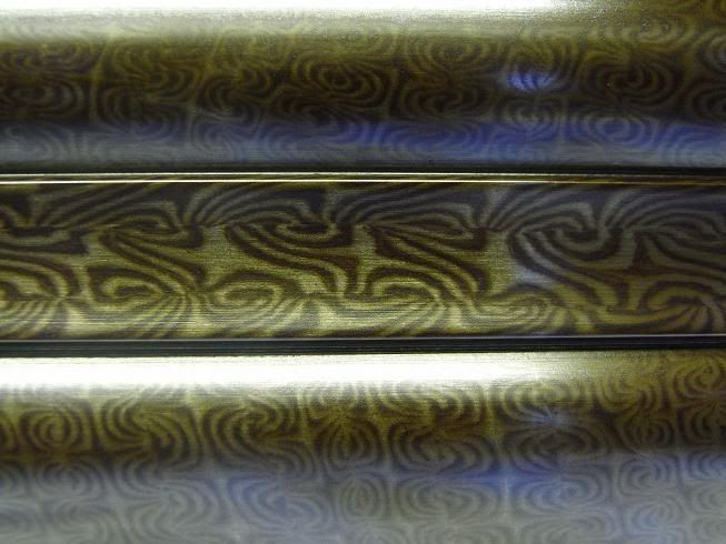

More often then not the ribs are different pattern than the barrels but I have seen them matching also. There is a great book called Three Centuries of Liege Gun making. It has a lot of info on the making of Damascus barrels and their construction

Sorry Dave.
I've still got about two hundred pics to look through, but have come up with a bunch of good examples of tubes and ribs with the same, or very different composition here
http://www.picturetrail.com/sfx/album/view/21182597
Certainly the ribs did not require the strength of the barrels, and ease of manufacture and aesthetics had to be factors.
