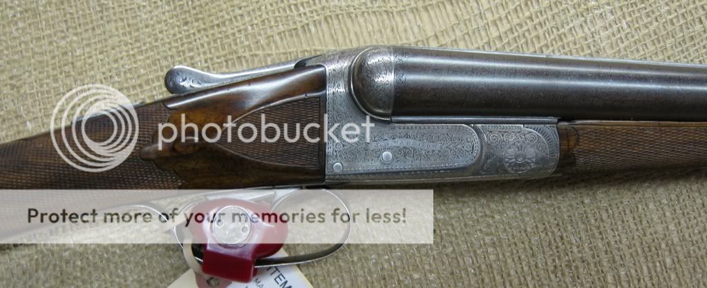

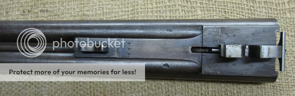

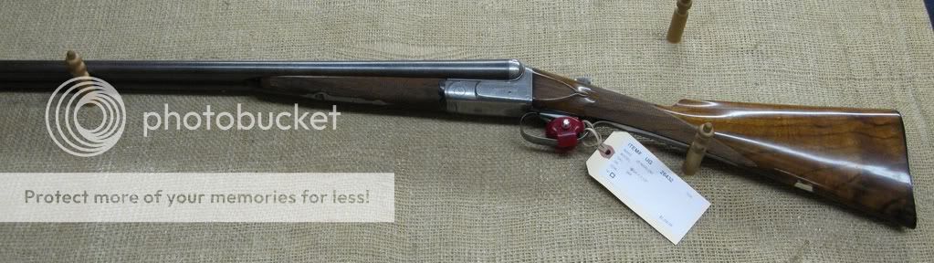

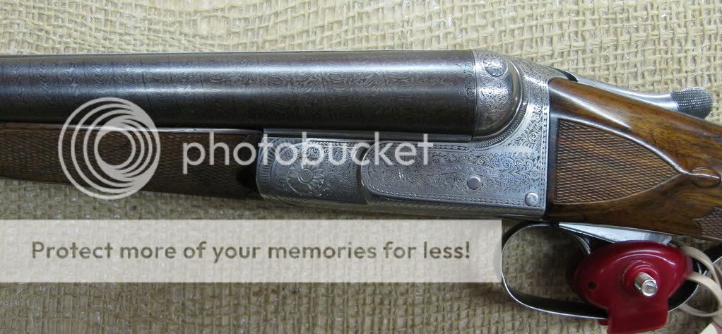

I came across this J.B. Warrilow 16 ga boxlock for sale here in Ontario. It's a couple of hours away and I haven't gone to look at it yet, but I wondered if anyone could give me their opinion on it from the photos I was sent. I've never owned a British gun but thought this one looked interesting. From the research I did it seems to have Birmingham black powder proofs only. Is that correct? Would low pressure smokeless shells be safe to shoot if the gun is otherwise sound?

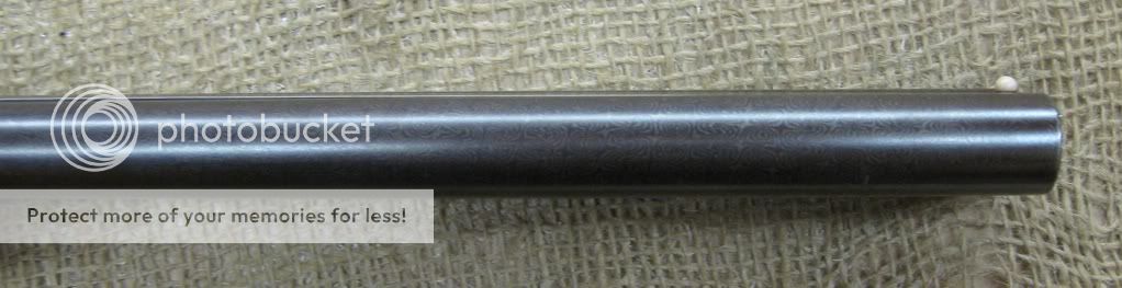

The barrels measure 29 1/2" and the chokes measure IC and full with a drop-in gauge. Are they likely to have been cut back from 30" or could they have started out at 29 1/2"? I called back and asked how the muzzle looked - was told the edges of the bbls don't quite touch at the muzzle but no obvious signs of having been cut. If a half inch has been trimmed, should I stay away?

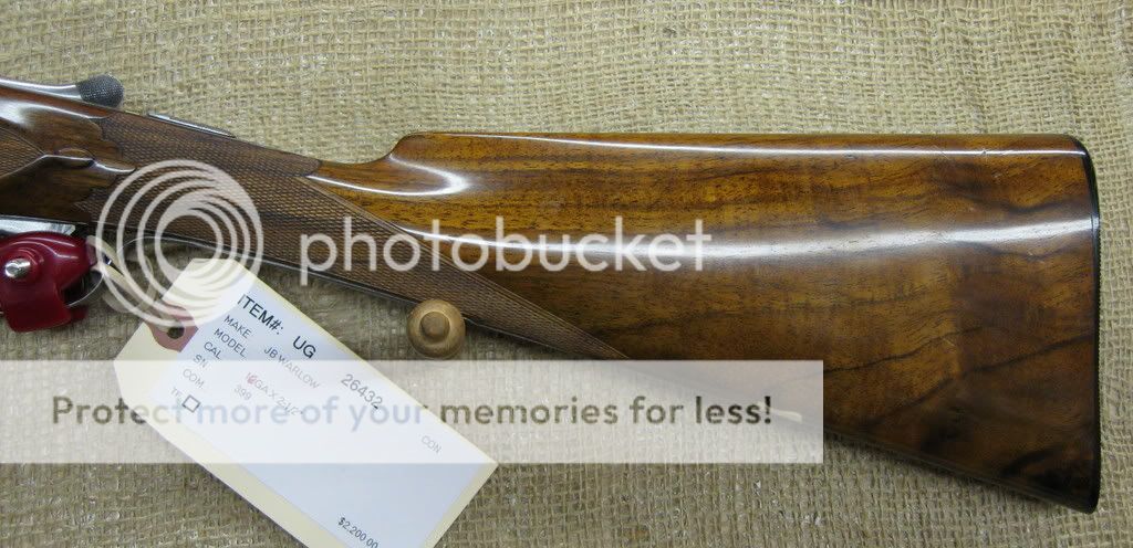

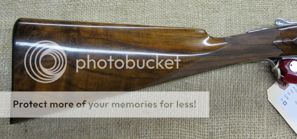

It weighs just 6 lbs and the stock is long enough for me, so I'm interested and would like to hear any opinions. The asking price is $2200 (Canadian). Thanks

I have a Warrilow 12ga that has about the same amount of engraving than yours, mine has London Proofs and my gunsmith thinks it may have been a Belgian made action finished in England due to the use of pins instead of screws. Mine has a Greener crossbolt as does your but you have bushed pins which I do not. Mine has an Anson Deeley number, yours doesn't. The only thing I have ever found out about them is that Boothroyd seems to think they were made by CG Bonehill and yours certainly was. Mine however has no such mark so it seems to me Mr. James B. Warrilow of Chippingham, Wiltshire sourced his guns from more than one maker.
Yours is only the third or fourth I have heard of, one was a 20ga.
Yours looks to have been refinished, the bead is new and the bottom strap seems proud of the wood. The barrel length wouldn't bother me if there was still enough choke to suit my needs and the gun was sound. My barrels are 28" even and I had mine reproofed for 2-1/2" smokeless, the proof house told me they would pass it for 2-3/4" if I wanted but I passed on that.
It's about $1880 US not a great deal but not a bad one if the gun is sound and it fits you, plus it's a 16ga. Have the bores and walls measured though.

dmh, the gun is definitely Bonehill built,as it has their patent
ClipLump under the the barrels.Bonehill was a major maker with a large factory so this is not bad.The gun appears to be a non-ejector and has damascus barrels.Obviously good quality and has been refinished as mentioned. I think your attention should be focussed on how good the barrels are.Are the bores clean? What is the barrel wall thickness.Looks like it was built at 17/1 which means the bores were less that .662 when new. Check what they are now.Barrel length is probably original and it does have only black powder proofs which probably means it was built pre-1896.
Price seems OK if the barrels are good

If I wanted the gun and it was in good condition bore and choke wise I'd offer him less based on it being a 16 ga. and not Nitro proofed.
