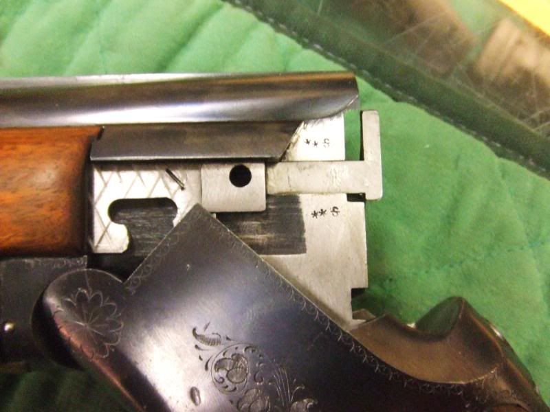

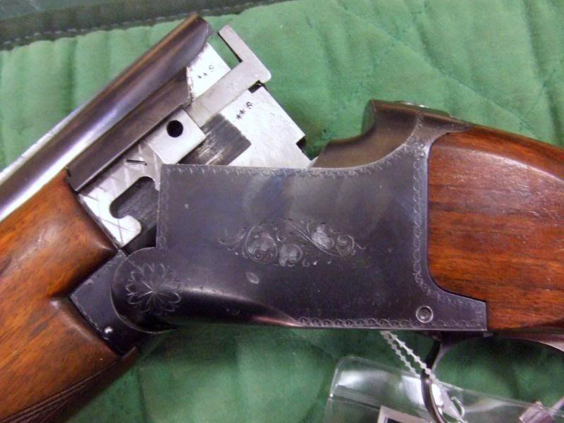

I went back and looked at the gun a bit closer today and this is what I found out. The pad looks to be a replacement Old English black rubber pad and with the pad the length of pull is 14 3/8". Serial number is 105XX and it does have the long triggerguard tang. The barrels are about 26 1/2" and the choke stamps are showing **S for both barrels (skeet?). I took some pictures but I haven't had time to put them onto the computer yet. I would say after a closer look that the finish is still about 85%+ and possibly better. I did not have a chance to measure the chokes in the barrels. I also don't know whether the 26.5" would have been an original length or if the gun has been shortened at some point. There are no obvious signs that the gun has been shortened (at least not by someone without experience). The seller offered it to me for $799, good deal?

Does the gun have a rib? A prewar ribless Lightning would be well worth that money if the barrel condition is excellent. Any prewar Super in clean original condition should be worth that price. Some prewar Lightnings have ribs. The way to tell whether it is a Lightning is the weight. The prewar version of the Lightning is much lighter than the postwar version. If your gun is a ribless Lightning, it should weigh around 6 1/2 pounds. With a rib, it will still be well under 7. A Standard Weight will be 7 1/4 to 7 1/2 pounds in the same configurations. It probably has the second generation single trigger with the selector made as part of the safety. Some of these 10,000 series guns were not shipped until 1940 or later. Post some pictures so we can see what your 85% looks like.

Thanks for all the responses, here are a few (not terribly good) photos that I took of it yesterday. As for the rest, we do have a lot of doves in North Dakota so I'm sure I could use it that way. I'll think about it a bit first. Here's the pictures.
