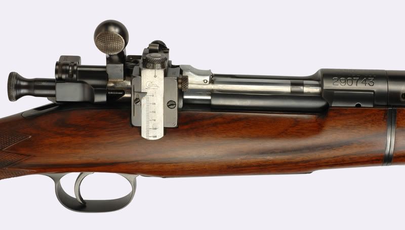

The 1903 Springfield does not work well for DST because of the small triggerguard. The typical German solution was to use a shotgun triggerguard to accommodate them. Occasionally you will see a triggerguard that has been lengthen. I don’t remember who sent me these photos, if this is your rifle let me know.
Not my rifle but the way the trigger guard was lengthened is interesting. I have a sporter built on a Romanian M93 action that was a bring back from WW2. It is fitted with DST and the original military trigger guard was lengthened the same way with the separate interlocking piece to the rear to accomodate them. This one forming a shotgun guard w/tang piece down the grip.
Don't know if the pics show it or not.

Another alteration to look for, the bolt lock to keep the bolt from accidentally rising when the safety is off. I’ve only seen this modification on rifle by Barney Worthen of San Francisco. Notice the spring loaded plunger in the front of the safety lug.

That bolt detent is a neat piece of work. How effective is it?
Jerry Liles
Joe, What other details would you or others have an interest in, from any maker?
Jerry, When cocked and the safety off the bolt raises very easy and will cause a misfire, this works well to prevent that.

Michael, the little bolt detent is a perfect example of the things I find most interesting. Installing a detent on a Mauser bolt is easy, the Oberndorf factory showed us how in at least 2 different ways, but the 1903 has always been a puzzlement to me. Some other areas of interest include a trigger-block safety and the details of its retention & positioning, and a closeup view of a Shelhamer grip strap. I'm not interested in using that feature myself but would like to be able to determine the authenticity of any purported Shelhamer stock that I may encounter. Bench-made peep sights of the Krag/Rice type or the one you showed recently on a 1903 would also be quite interesting to me, as would any tang safeties or other unusual alteratioms for scope use.
