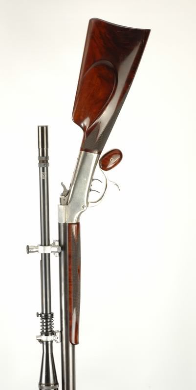

This has been my “Go-To” benchrest rifle for more years than I want to think about. I have fired ten’s of thousands of rounds with it. The barrel is by Niedner in caliber 32-40 throated for the 185 gr Hudson bullet, the stock is by Wills and yes, the action is an original nickel plated one. The buttplate is a Niedner style.
