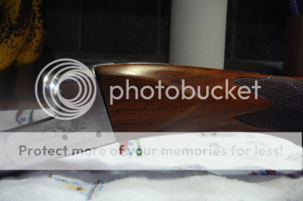

I got the horns to fit but I have a major gap any ideas how to fix just trying to mock it up before the metal goes out for finishing.
Posts: 2,403
Likes: 17
Posts: 2,403
Likes: 17
I am no stocker but it looks to me your 'new' stock didn't have the same drop as the old one. You can bend the tang up(might break even with heat) or re-head the stock.

Sounds like a job for Gunter not me. I thought about bending it but then the lever would need to be bent also and it might break as you said (my luck). I have a 16ga and I heard that the stocks may be interchangeable with the 20 maybe I will part it out and save this stock for something else. I will have to think on this. Thanks
