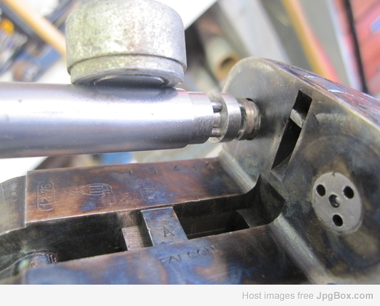

Cole's tool has a continuation of sorts, past the relieved area behind the business end where the pins fit in-he drilled it far enough for the pins to drop into a second hole, in addition to the hole they are inserted into.
You can be sure the pins haven't skewed one way or the other in use by simply looking they are bottomed on the second hole. I suppose he could have simply made the holes full length, and not cut the relief just behind the business end, but, that wouldn't have been as elegant.
I usually put a small rare earth magnet on the shank, near the pins, to keep them in the tool. It does not look elegant, but, it keeps the pins from falling out of the tool. This is a view of the correct tool, for this application, in use. Having the correct tool can't be stressed enough:

Salopian,
As I'm sure you have done already, a Google search shows T. W. Menck's Ralston, Nebraska shop permanently closed.
I have one of his 2- Bit adjustable firing pin bushing tools as he calls them & it works well & is made to use a 1/2" socket. His instructions suggest using an impact driver but I've not found that necessary (yet).
He has a good drawing of his tool in his instructions & failing your locating one somewhere it does not look like it would be too difficult for someone with a lathe to make one.
I'm not good at posting photos but if you want to PM me with your E-Mail address I'll scan the instructions & send them to you.
Nothing wrong with the Cole design either but on a gun that has been fired much you will want something more than a slick handle to provide some torque.
Those striker disc tools that have a handle that looks like a chamber brush handle are most useful as case accessories but I imagine you already know this.

Salopian,
You can build a better tool than what is pictured. The adjustability is the Achilles heel in the Menck design.
Build it specific to the task at hand. You may end up with three different tools, but, that is better than wishing you had three different tools after the universal model didn't work out.

Having actually used the Menck tool to successfully remove a couple of striker discs w/o buggering up either the striker disc or the breech face I don't think I would change any thing if building one from scratch.
The adjustable spacing of the design allows a very precise fit of the pins to the striker disc holes & once adjusted is very solid.
The one thing I would change is the instructions for use:
1. To prevent burring the holes in the striker disc I first precisely fit the pins to the holes (I bought extra pins when I ordered my tool) leaving the original diameter on the back side of the pin where it fits into the tool face.
2. I would not use the recommended impact driver unless I had tried all other alternatives first. With the 1/2" drive you can provide plenty of torque with a T handle or breaker bar & have a lot more control of the tool & if that didn't work I would set it up in a vertical mill or heavy drill press so you could maintain heavy pressure on the tool while turning it by hand (same technique as used for really stuck screws).
The objective is to remove & replace the striker disc & having it look like it was never removed in the first place. This may not be possible in all cases & at the very least we want to avoid marring up the breech face. New striker discs can me made & fitted if all else fails but the breech face is difficult to repair.
