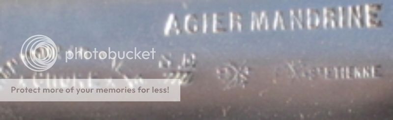

Raimey, my digital camera fits in my shirt pocket, the photos aren't the best.The numbers read, left to right, 1900 and 8975. The guns serial is 759, that also appears on the under rib.

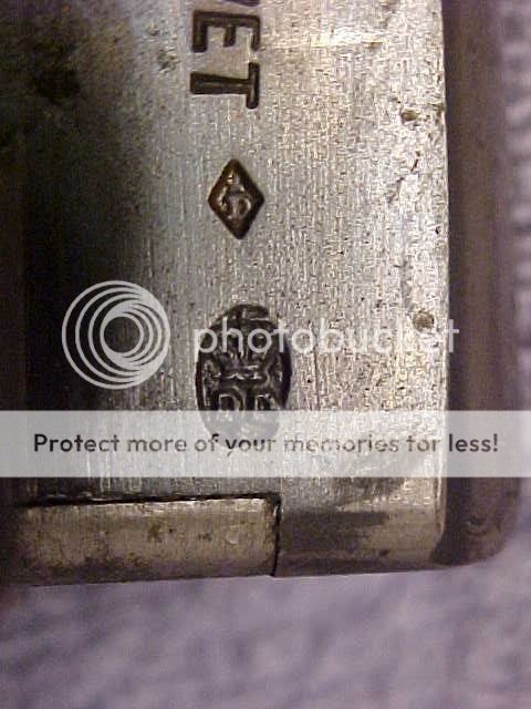

The oval, on the underside of the right tube, in back near the lug, has a crown with the initials DD and a tiny star under it. There is a tiny triangle with a D in it on the other side? Didier? Maybe.
"Acier Mandrine" would lead one to think mandrel drawn steel tubes.

I'm confident on the 1900 date for the tubeset. What are the characters near the SGDG - Sans Garantie du Gouvernement( 'brevets sont délivrés sans examen préalable, aux risques et périls des demandeurs, et sans garantie soit de la réalité, de la nouveauté ou du mérite de l’invention, soit de la fidélité ou de l’exactitude de la description '), FON RTN?

I'm confident on the 1900 date for the tubeset. What are the characters near the SGDG - Sans Garantie du Gouvernement, FON RTN?
Raimey,
Sorta.
The letters "Fon R Tee" appear before the S.G.D.G. The barrels are double proofed.

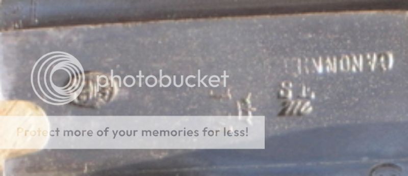

skeettx, can you tell us what's in the oval on the breech end? Also what is the xxxx.xxxx on the underside of the right tube?

The marks you asked about are very clear, and what appears to be marks that are rubbed off are boat rash and the typical things you see on a 100+ year old gun. I will try to get a better photo up tomorrow.
Most of the marks are pretty clear considering the age of the gun, and the condition of the rest of it, which, is the commonly seen "rode hard, and put up wet". This example, has bad gunsmithing, to boot. It is an unfortunate fact that a guy who is well qualified to pull down and repair a SLE, may be well over his head with a sliding breech, of any design.
Can not tell you
but here it is

Indeed, seems as if it was defaced? Is the other cheek any better. For sure, your tubeset was completed in 1918. Any hard info to indicate otherwise? We may be on the cusp of stating that Didier Drevet serialized his tubesets akin to what L. Bernard commenced(Did L. Bernard surpass 14k tubesets?).
Another of my French guns, so I am guessing it is a manufacturer stamp.
Posts: 12,847
Posts: 12,847
Possibly Marsot's liability stamp? Know any other Darne types with Didier Drevet tubesets?

Ah yes, Didier Drevet, DD surmounted by a Crown in an oval.
Permit me to rephrase, do you have knowledge of any other Didier Drevet tubesets with serialization?
I do not, perhaps others here??

Interesting ACIER MANDRINE tube steel type. There's some patent info on the underside of the right tube.
Acier Mandrine- mandrel steel- turned on a lathe?

A few comments, that could be improved with the pictures:
- Fon Btee is I believe for
Fabrication Brevetee.
I.e the manufacturing process is (was) patented.
- the barrels are from the 1900 time frame indeed.
Poudre M was used until 1905 or so.
The chamber marks are in cm (6,5) and not in mm (65). I am still struggling with the exact date of change but believe it to be in that same time frame.
- "Mandrinage" refers to a test done by inserting a cone in a hole and looking for permanent expansion without cracking.
You can google "mandrinage canon" for references on that subject. The technique was used for artillery tube testing and many other parts such as nuts and railcar hooks.
In this context, it would mean that the steel used would have been tested accordingly.
The other meanings of "mandrin" are "chuck" (machine tools) and tubes used to wrap paper or fabric on. A mandrin is also used for damascus barrel manufacturing IIRC.

Larry,
With all due respect, you are wrong on that one.
Here is a quote found in a google book. (and there were quite a few...)
"d'une plaque de metal prealablemcnt mandrinee de facon a former un cylindre".
Of course the accent is missing (eliminated by Google)as much as it is on the gun (capital letters normally don't have accents).
Dictionnaries are haphazard on old technical wordings. But this was an active technical word. It is not a Brand. It is an adjective and it is germane to barrel making to boot
So there.
Best regards,
WC-

I don't recall but is the stamp of SE over script M(on each tube a well as flats) a maker's mark or proofmark?
Posts: 534
Posts: 534
I really don't think it is a proof mark.
I have never seen that mark before.
The DD mark is now well recognizable.
Didier-Drevet was a famous barrel maker.
I don't know if Pierre Drevet who was the CEO of the Manufrance starting in 1945 was directly related on not.
Dider-Drevet was incorporated into Verney-Carron along Jean-Breuil in 1963 IIRC.
WC-
Posts: 12,847
Posts: 12,847
I think it to represent our culprit/mechanic/entity?? Not sure why he applied it was many times as he did? Any possibility @ all that SE is St. Etienne?

Good catch on the capital letters. But that's only a POSSIBLE solution. Might also be a brand . . . especially since I came up with someone named Mandrin. No way to tell for sure, with no accent to help us. Either way, have you ever seen it on a barrel before this example? I haven't . . . or can't recall if I did. A bit odd that the word, whether a brand or a technical term (actually a past participle used as an adjective, if that's what it is), doesn't seem to have been used all that often on barrels.
Regards,
Larry
