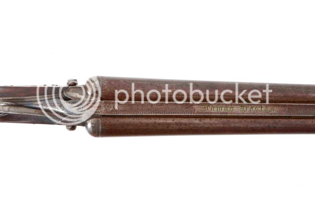

Some have seen this thread but I thought I'd go ahead and post it here to clear up some issues
http://parkerguns.org/forums/showthread.php?t=15082
Good place to start
https://docs.google.com/a/damascusknowle...MNs5L2XVfc/edit
It all starts with the lopin or billet: thin strips of iron and steel called 'alternees' or leaves.
The lopin is heated, hammered, and/or rolled into a rod, stripe, band, blade, iron, or rope – THEY ALL MEAN THE SAME THING and in the finished barrel are described as a 'scroll' by their appearance in Crolle pattern damascus.
The scrolls are larger in 2 Iron/Stripe and (usually) progressively smaller 3 to 4 to 6 Iron.
The size of the scrolls is dependent on how tightly the rods are twisted before being hammer welded into the ribband AND how many alternees are in the rods.
2 and some 3 Iron/Stripe crolle patterns usually have 7 or 8 steel (which stain black) and 7 or 8 iron (which do not stain so silver) alternees or leaves within the scroll.
2 Iron
3 and 4 Iron might have 6 and 6.
Parker D3 refinished by Dale Edmonds
4 and 6 Iron usually have 4 and 5 or 4 and 4. End view of the rod with 4 steel and 5 iron alternees
4 Iron
6 Iron with 4 and 4

More complex patterns of course require more complicated 'stacking' or 'piling' of the billet, as shown by this Washington or American Flag illustration.
The Damascus and Twist barrels of most U.S. gunmakers were finished in a black and white pattern; BLACK BEING THE STEEL AND WHITE, THE IRON AFTER STAINING. In this illustration however, the black 'stars' are iron and after finishing will be silver.

My only resource for Damas Moire' is here, only partially translated from the original
https://docs.google.com/a/damascusknowle...67VsZgzJ9Q/edit
Canon ŕ ruban moiré et ruban anglais
By manufacturing the lopin, to make the iron and steel barrel from which I come to speak, it arrived sometimes that the forgeur is misled, with the of place; ce qui avait confondu toutes les mises ensemble. The canonnier, unaware of the error made, once the forged and déroché gun, is found amazed to see appearing a completely odd nuance, imitating the effet de moire. It is this the Canon Moire' was called.
This kind of barrel, whose discovery is, as one sees it randomly, due, is very resistant; unfortunately it is too prone to present pailles, because of the number infinite of the weldings of which always some are imperfect. By joining together three or four pieces together and by always preserving the dish of the settings corresponding to the dish of the ribbons, one obtained a little later finer watered effects. It is with Celt variety of moire that one gave the name of English ruban.
Canon ŕ rubans fer étoffé
This ribbon is to some extent that a variety of watered effect. To do it, the pieces are composed as we will explain that one does it for the Damas mouchetés, to say one joins together 100 iron alternees and of steel, square, alternated, that one welded and stretches directly in rubans like one does it for the watered effects, without making torsion and of the second welding as for the Damas.
I suspect it is a variant of "English Damascus Twist", Damas Anglais Coupe', Gebrochener Englischer Damast, or Combination Damascus; and both seem to be mid-1800s patterns.
H. Needler 12b percussion double.
More examples at the beginning here
http://www.picturetrail.com/sfx/album/view/19228742

Drew Hause #465340 12/13/16 10:22 PM
Posts: 12,847
Posts: 12,847
Terms DAMAS BOSTON on an early Belgian sidelock.
Cheers,
