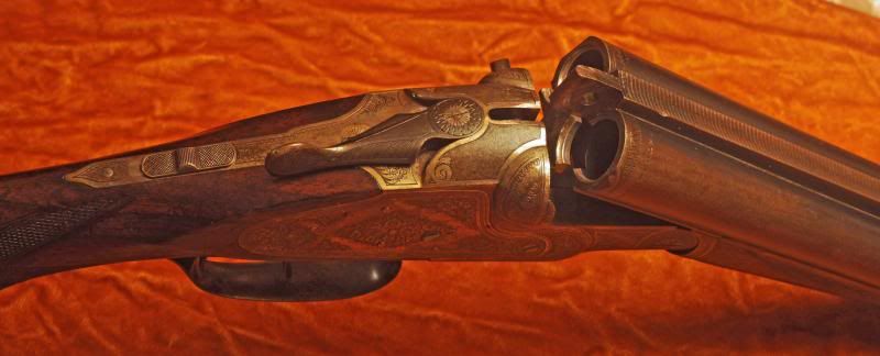

I'm looking for information on a German 16 ga. SxS. Barrels are marked Eduard Kettner Coln-Suhl and Mark Rhenus with serial#24291 and the word Nitro. The gun is a sidelock with fancy floral engraving, cocking indicators, and sideclips. If someone provides posting directions, I can send photos. Thanks in advance

Eduard Kettner was mostly a dealer, trading in guns built by others.If the word Nitro is in "block"letters, it was proofed in Suhl(and likely made there);if it is in "script",it was proofed in Zella-Mehlis( and likely made in the area).Photos would be helpful.

Thank you for the replies. Please bear with me. This is my first attempt at posting a photo. I can post more if this works.
[image]http://i163.photobucket.com/albums/t297/welderman_07/Kettner9_zpsa9da219a.jpg[image]

Gunwolf, maybe I missed something, but the Kettner I found in the link was a very nice Franz Kettner Taubenflinte for sale. Raimey's link pretty much said the same as I, that Ed.Kettner firm was mostly a dealer,dealing in guns made by other Suhl makers( they did have to have a meister on staff).As always, I can be wrong.

The Kettner you describe is a beautiful piece of work, but I suspect it is from a more recent decade, possibly a more recent century. The Kettner I am interested in appears to be a pre-WW1 weapon. I have a copy of a business card printed in 1913 that describes the Eduard Kettner facility at Hohestrasse 67. It sure gives the appearance of a factory. The words say "Koln-Suhler Mechanisch-Gewehr-Fabrik.It gives the appearance that Eduaed was a serious gun maker and not only a retailer of other people's guns. Sorry, I am German challenged and can not read the links you have provided. Best Regards

The 16 ga has 65mm(2 1/2-2 9/16")chambers and both barrels are choked(likely pretty tightly) and I think it was made between 1912 and 1923.As usual, I could be wrong about the date.
