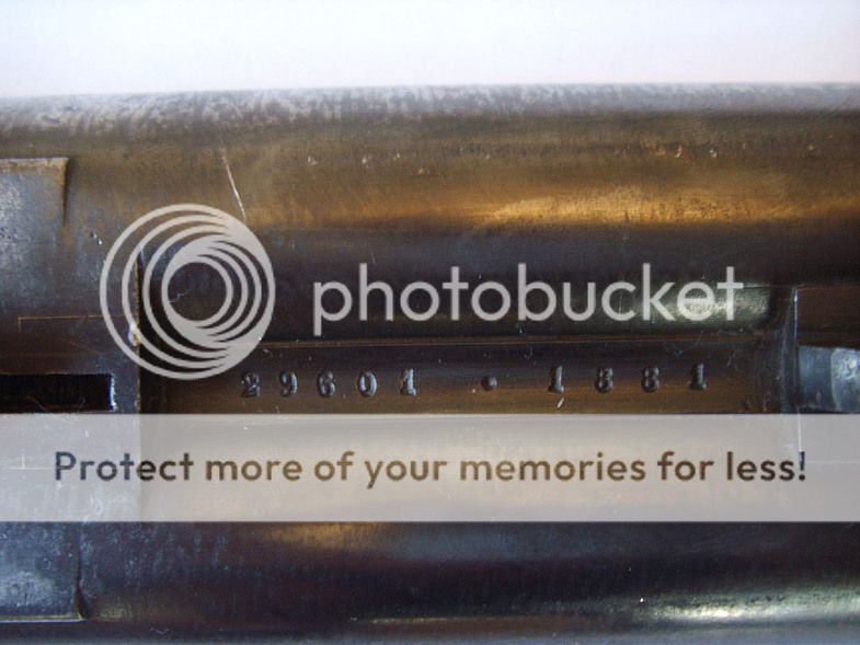

Posts: 12,847
Posts: 12,847
29601.1881
They seem linear with the above then and you give Guyot #30685 : 1882
