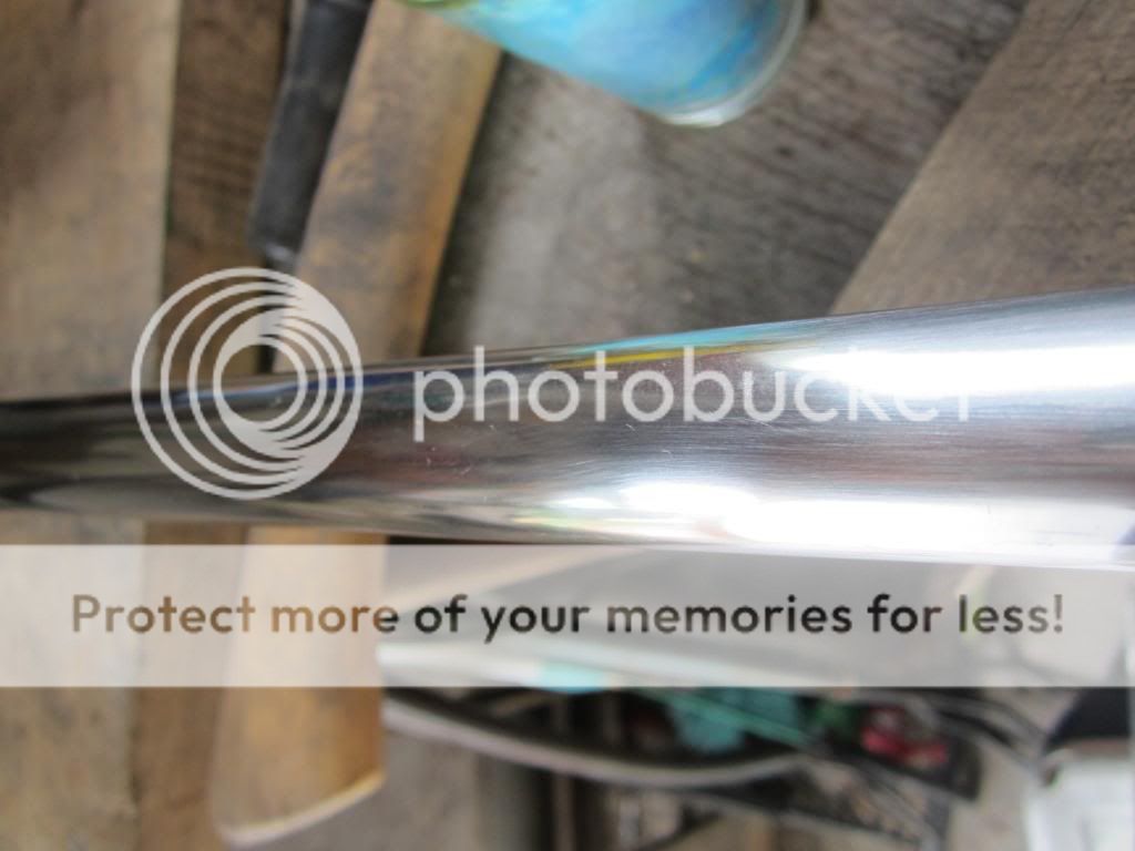

some of the pits dressed down, and polished progressively finer back to 600 grit

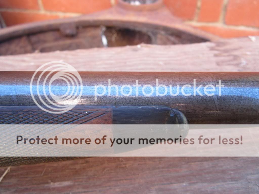

Done:
After half a dozen or more cycles of rust, scrub, degrease, rust etc and the final scrub and degrease, I dunked it in a bath of hot water and bicarb soda to stop the rusting action. Dried it, rubbed a bit of linseed oil to highlight and protect it.
Came up better than I thought it would:
It's possible to see the join just ahead of the forend where a different, thinner riband was joined to the thicker breech end.

Some observations:
I was a bit concerned that the environment I had the barrel sitting in (cool, dark, dry) and this time of year (warm, dry) would not be humid enough to promote the rust I needed for browning. That proved not such an issue.
The value of thorough attention to detail, in the filing and polishing of the surface is important (but I suspect I didn't need to go as fine as I did); a few pits I could have taken deeper, some blemishing around the breech end I could have hit harder, as they've left some unsightly darker blemishing.
I had thought I wasn't going to get much pattern/contrast/colour, even after the final scrub (and it's not the most exciting pattern either), but I stopped as the barrel appeared not to be changing much after about 6-8 cycles. It turned out better than I'd thought after rubbing with linseed oil, though not as brown as I'd hoped.
Not sure whether it's "greys" in the metal, or whether I should have scrubbed harder after the copper bath, but in bright sun there's golden flecks in the metal ahead of the join near the forend; that they don't appear at the breech end makes me believe it's in the way the metal took the finish, rather than my attention to detail in re-finishing.
